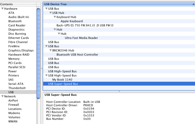

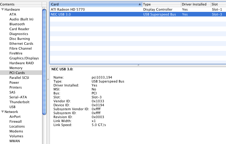

I have a mid 2010 Mac Pro v5,1 OSX 10.6.8 and am having trouble trying to upgrade it by installing a USB 3.0 PCIx card. It seems like so many others have had great success with this: https://forums.macrumors.com/threads/1238494/
However when I tried it doesn't seem to work. When I installed a similar card with the NEC D720200F1 chipset, hooked it up to the internal power, and after trying various PXHCD.kext files (all which have worked for others on other forums) mine doesn't seem to want to recognize anything plugged into it, USB 3.0, 2.0, or otherwise. What really doesn't make sense is that the PCI card and USB connection both show up in the system profiler. The only thing I can think of is that there is some other kext or some other file that is interfering with the proper functioning of this card. (I had a similar problem a while back with a LexarUSB.kext that was interfering with reading DVDs in my optical drive, but once removed it was golden....how someone figured that one out baffles me lol). Anyways if anyone has any suggestions out there, I would love to try them out.
Thanks in advance for all your help.
Cheers!

I actually have a driver for 10.8 as well which I tried out just for fun but it messed with my system not recognizing my mouse, or any other peripheral for that matter and had to do a reinstall of my OS (10.6.8) to get things back to normal. When I ran into that problem I tried the Apple call center, as I have an extended warranty, and asked if they knew anything about it, but they weren't much help as its a third party issue 😕
Like I said, the driver can't be the problem as it works for others, like yourself, so there must be some other file interfering with it somehow. Unless there is a slight difference in the chipset - are all the NEC chips the same? Does yours say NEC D720200F1 on it?
Thanks!
Yes, that's exactly what mine says... since it's sitting here on my desk as I had no reason to keep it in my MP now that I'm on 10.8.

Awesome... That worked for me! Thanks! I wish I could help you out. 😱 I can only suggest try unplugging and uninstalling all additional hardware (eg. all other USB devices for sure and any other expansion cards you might have) to see if a dead stock system gets your USB3 working... then start adding things back until it breaks.
I have no other cards installed and the only other add ons are a 2TB WD external using FireWire and a 3TB WD external using USB 2.0 (but USB 3.0 capable!). I was kinda guessing it might be the WD drivers I installed but haven't tried removing anything yet. My question is if I start taking out files one at a time, do I need to do a complete restart each time for it to completely work? If so that will take forever! Argh! I was also thinking I could create a fresh OSX partition with the ONLY addition being the PXHCD.kext file and seeing if that works.....
