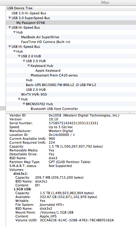

I have attached to my iMac a certified USB 3.0 drive by by Western Digital. I have attached the system profiler information. See attached.
It does show that the drive is connected to a port that can be as fast as 5Gb/s.
So far so good.
Then i do a drive speed test using Blackmagic Design Speed test app.
Reported drive speeds are 75.6 MB/s for read and write.
I then do another test by copying a file from iMac internal fusion drive to the external USB 3.0 drive.
File is 4,396,618,989 bytes, and copies to USB 3.0 drive in 59 seconds.
4,396,618,989 bytes / 59 seconds = 74518965 bytes per second
This matches the Blackmagic app speed so i have to assume this is the drive speed in USB 3.0
Will i suffer the same type of disappointment in getting a thunderbolt drive?
Since its a hard disk inside, will the speed also be around 75 MB/s ?
Thanks.

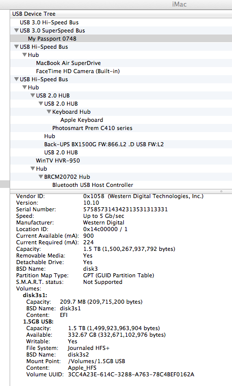

So far so good.
Thanks.

75MB/s is above USB 2 limit, so the connection is certainly USB 3.
According to Tom's Hardware (http://www.tomshardware.com/reviews/hitachi-western-digital-terabyte,2017-3.html), you should see an average speed of 85MB/s and the max at 106MB/s from your drive.
There is no faster operation than copying a single large file, so I would expect the speed close to 100MB/s.
You copy from Fusion drive, but we don't know if the file is on the SSD part of it. Could you copy it in the opposite direction? Than we can count on it to be placed in the SSD's 4GB "catch-all" part, so you would really measure your HDD read spead and USB transfer.
Late 2012 and 2013 Macs are capable of 200 per second on HD with the right USB3 single external enclosure via a new UAS protocal. Lacie, Caldigit, and a few others have this in some of their products. I personally witnessed 200 up and down on a recent install with an iMac & Caldigit AV Pro external. The same device loaded with SSD reaches over 400. http://www.barefeats.com/hard162.html
UAS first arrived on a few PC boards mid 2012
Not a peep from Apple on this, but it's there.
