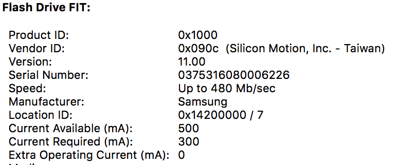

The issue is with one USB memory, it is a Samsung USB 3.0 Flash Drive Fit 128GB.
My computer is a MacBook Pro Early 2015.

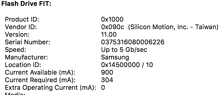

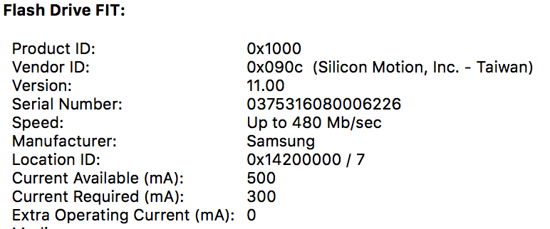

I connected it to the right port and the speed is displayed as "Up to 480 Mb/sec", So I thought something must be wrong... either with my port or my memory.

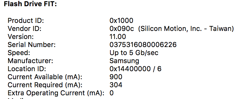

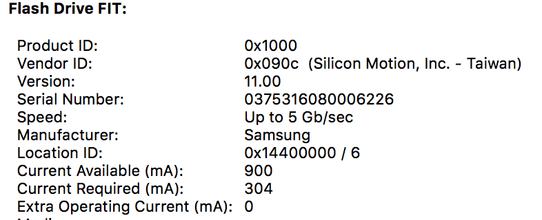

So I connected the memory to the left port, now the speed is displayed as "Up to 5Gb/sec"
It seems the memory is Ok, but maybe the right port is busted...

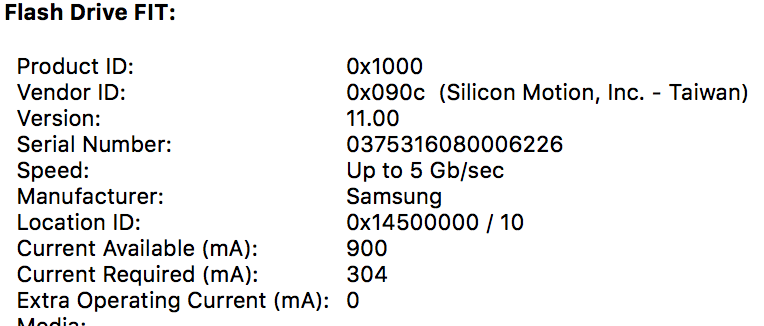

While I was scratching my head I saw an USB 3 extension cable, I hooked it up to the right port and the memory to the extension cable... to my surprise, now it is detected as "Up to 5Gb/sec" I was like "What?!"
Why would it be detected correctly with the extension cable but not when it is connected directly to the computer?

Right port:
Left port:
Right port using extension cable:
The only difference is the available mA. For some reason the Mac isn't allowing it to draw as much power from the right port unless there's an extension cable plugged in, though it works natively on the left port. I'm not sure if the mA would affect the speeds, especially because it only needs to draw ~300mA, but going on your screenshots that's the only consistency between the speed drops.
Do you possibly still have AppleCare on the machine? Also can you use any other USB drive for testing purposes and have a look at the available mA through the left/right port, with and without a cable?

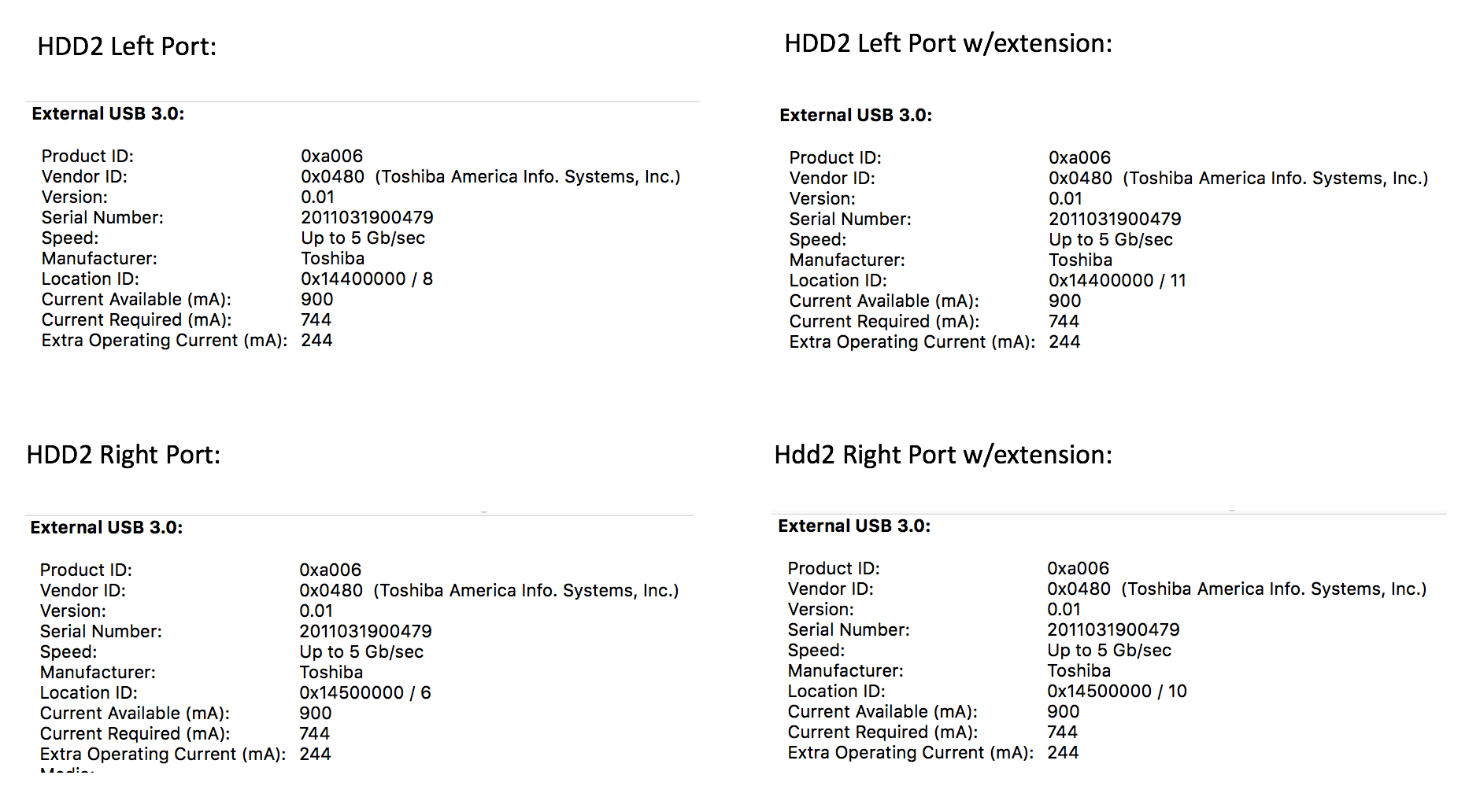

I don't have any other USB Stick, but I have 2 USB 3.0 HDD, for which I attach the images
HDD1 is the original 500GB PS4 drive in a Seagate Expansion Enclosure.
HDD2 is a Toshiba Canvio 1TB that I bought around 2011, I guess I should get a newer one :

Hmm that's very odd. You can see in your screenshots that the Current Available is 900 in each instance, no matter what device you're using. It only seems to drop to 500 with that Samsung Flash Drive directly into your right-hand port.

2) Hardware related: this is where it gets a bit tricky. The immediate thought would be that it can't be the USB stick, as it runs full speed on a different port, so possibly it's the right-hand port on your Mac that's faulty. However all other devices have the correct Current Available output of 900mA, so the problem just seems to be isolated to one peripheral, which would indicate the stick's somehow at fault.
3) The Current Available at 900mA has no bearing whatsoever on the speeds and it's just a coincidence that the drop in current correlates to the drop in performance, meaning the problem is somewhere else. 😕
