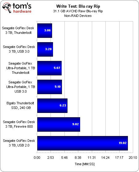

This kind of makes sense in simple terms, and is often seen as an explanation on these forums why TB is not worth it, but reality is a bit more complex than that.
Even a single 7200 RPM drive will be faster than USB 3 when connected via TB.
14 seconds for a 31.1 GB single file sequential transfer. Not a massive difference in this use case

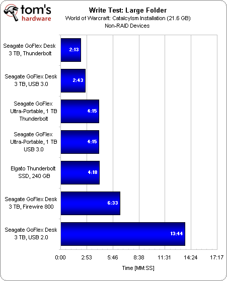

The difference is much more noticeable, however, when doing read/write operations on many smaller files, due to USB 3's lack of command queuing.
30 seconds
Thunderbolt's benefits become clearer using single-drive devices with 3.5" disks. Moving a single file to the GoFlex Desk resulted in similar performance from Thunderbolt and USB 3.0. However, USB doesn't support command queuing. As a result, Thunderbolt takes a 22% lead when transferring bulk files. This is also an advantage when it comes to editing video, as data caching behaves similarly.
