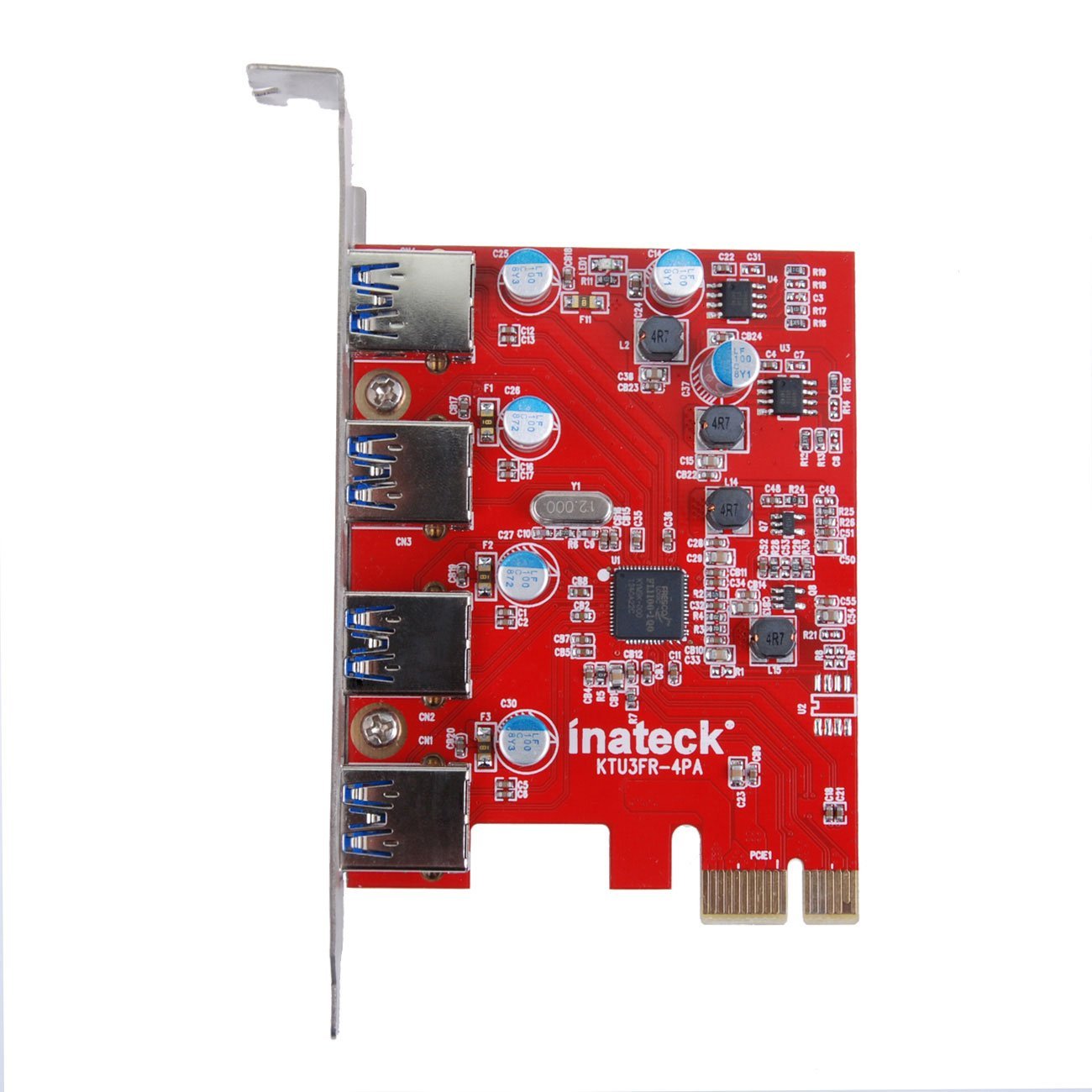

Thanks, problem is I can't get the Inatek card here in Canada and its the only card that will support USB hubs and doesn't require supplemental power, so I am out of luck.
The seller of the Inateck card on AmazonUK (SpringRainUK) will ship internationally, but you have to order outside of Amazon.
Alternatively, you can try the Orico pfu3-2p. This has worked without power for many people. However, I've pulled it from the recommended list in the first post due to QC problems. 4-5 people reported various problems from poor speed to DOA. It's actually the card I use. Although I bought the Inateck, I haven't gotten around to installing it yet mostly because my current card works fine.

The inateck card has only enough pins on it for a 1x pcie lane, so sticking it in a 4x slot will be fine, and anything more it will not make it any better.
What I want to know is if it will run a full speed in the 4x slot, which you said it will, but the Inateck site didn't.

Just thought I'd chime in with my results with two cards on my 5,1, the Orico PME-4U and the Inateck KT4004.
The Orico card works in both OS X and Windows 8, but causes issues with Windows not allowing it sleep, hibernate, or even shut down. Any attempt at those three results in a reboot. Sleeping and shutting down work in OS X, but the computer takes an additional 30-60 seconds to decide it wants to do either of those commands. I believe there was some funniness about OS X complaining about drives that were plugged in when sleeping and waking, but I don't recall the specifics, unfortunately.
The Inateck card flat-out didn't work. Granted, I tried it without power as it had been noted in many places that it worked without additional power from one of the SATA ports, but it didn't work for me. Additionally, it added the same sleep/hibernate/shut down problems I had with the Orico card.
I think I'm done with USB 3.0 unless I build a hack. I don't want to fight with trying card after card, especially when I'm already considering building a new machine.
The Inateck model everyone is using without power doesn't even have a power port for hooking up power. If yours has a SATA power port, you have the wrong model.
The 4-port Inateck with a power port on it absolutely will not work without power hooked up.

The correct Inateck has no provision for additional power. I don't understand your statement "I tried it without power"

Hi there and thanks first off to all the good info shared here.
Taking the advice of the forum I have the 4 port Orico that does require power, running it in a 1,1 with Tiamo EFI to enable 10.9.2
Card works fine (don't have Windows on this machine so can't speak to that), my question is about UASP, the newer UASP protocol that provides much faster I/O speeds.
I've searched on this forum and also looked through all the Orico-provided info I could find but nothing seems conclusive. Actionablemango's Front page post explains that UASP is supported in the CalDigit eSata/USB 3.0 combo card, but I'm curious about the Orico or Inatek cards. Hopefully I haven't just been careless and missed the answer in this thread; my apologies if that's the case.
Does anyone know if these PCIe cards by Orico or Inatek utilize the UASP protocol for USB 3.0?

I don't think so
Neither of these cards support UASP.
Pretty sure the Inateck KT4004 does. When I connect this Plugable USB 3.0 dock into my KT4004 card, the IOUSBAttachedSCSI driver in Mavericks loads and is enabled (as per System Information,) and I can get 400 MB/sec reads and writes (according to Blackmagic Disk Speed Test) from a spare 250 GB Samsung 840 SSD.
Same thing happens when I use this Inateck USB 3.0 enclosure.
And to top it off, it's in a Mac Pro 1,1 running Tiamo enabled 10.9.2.
I already put my Orico PFU3-4P card into a Windows box and am using the driver available from Fresco Logic direct here.
I'm glad you're getting great transfer rates, here's what Inateck said to me when I contacted them directly.

And yes it is supported by some of their enclosures but not all. I have those too. I researched the subject before posting my review here and on my blog. I'll investigate further.
Then why does the IOUSBAttachedSCSI extension become enabled when I plug in UASP-enabled devices? I get the feeling you're talking to the wrong arm of Inateck; you should try to get a response from their tech support, not their sales team.

Thanks Crjackson2134 for effort in contacting and sharing the response from the Inateck marketing dept to clarify on UASP. Hope you're having a good weekend. 🙂
don't count your chickens..
Fresco Logic, who makes the FL1100 USB 3.0 Host Controller chip for the Inateck KT4004, has this to say about the chip's UASP capability:
Fully Complies with the UASP Requirements
FL1100 fully supports the UASP (USB Attached SCSI Protocol) standard, the next generation storage protocol designed for USB 3.0. This feature optimizes the transfer efficiency for the 5Gbps channel by eliminating some of the classic BOT (bulk-only transport) bottlenecks.
Also I have written to Inateck's tech support, not their sales staff, to verify UASP compatibility. So we shall see.
It's definitely possible that Inateck chose to geld the UASP capability of the host controller chip in some byzantine way so the card wouldn't need the additional +5V from an outside source, but the fact that Apple's IOUSBAttachedSCSI extension loads when I hook in UASP devices makes me doubt that marketing statement.

Direct from the source
From: <support@inateck.de>
To: <Earl Urly>
Date: Mon, 31 Mar 2014 16:56:51 +0800
Subject: Re:Question about the Inateck KT-4004 for Mac Pro
Dear <Earl>,
I can confirm that UASP is working under Mac OS 10.8.2 or above, as we tested this for ourselves already. Just give it a try.

Yeah, so UASP *IS* supported by the Inateck KT4004 in both Mountain Lion and Mavericks.
Marketing as usual tends to be misinformed.
