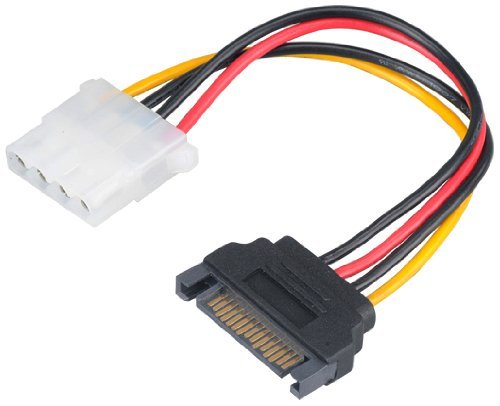

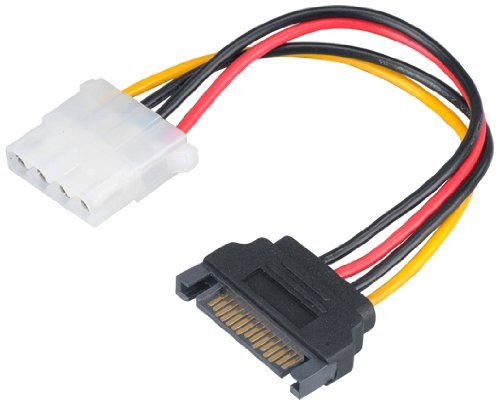

I also have an Orico 4 port USB 3 card. I used a 4-pin Molex to SATA power cable to power it.
The card has worked very well. however, I do have a minor gripe, the plate that covers the PCI-e slot didn't fit perfectly and took a bit of finagling before I could screw in the locking plate.
