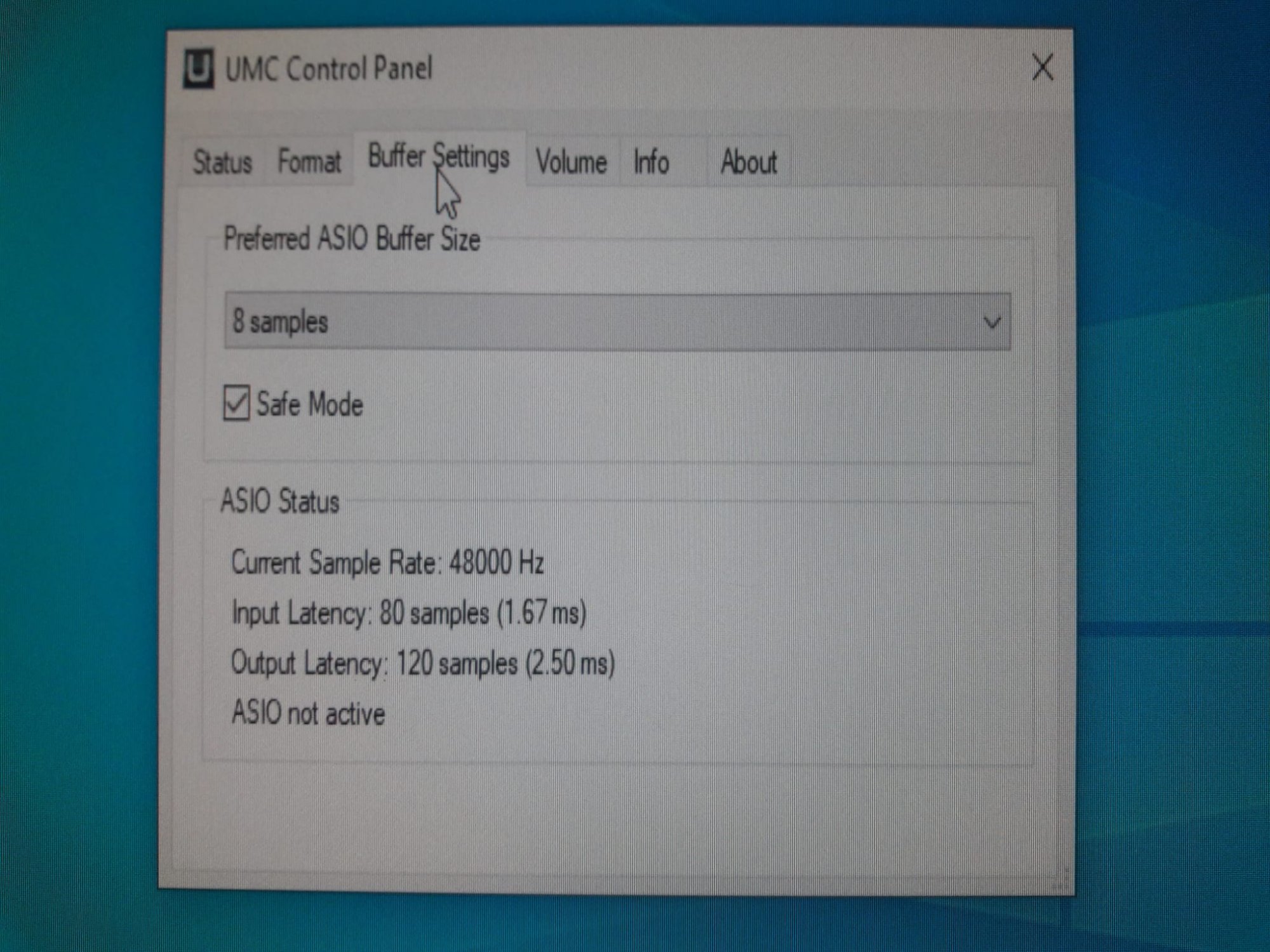

Hi gibelma - I am dealing with a similar issue with a brand new USB Behringer UMC404HD for use on my 2012 MacBookPro running El Capitan OSX 10.11.6 - for use with JamKazam (great program - we have been singing 4 part a cappella for 6 wk now). When first plugged in the audio latency was very high (15ms ? I forget - was very disappointed) That was running the 404 at its default max sample rate of 192khz and I got error messages that the input and output sample rates were different. Ended up degrading the sample rates to the lowest possible 44.1kHz (Mac - Applications - Utilities - Audio MIDI Setup.app). Now the Audio Latency as recorded by JamKazam is 9.8ms - that is for the 2.5ms Audio Frame Size (default). You can change the Audio Frame Size (JamKazam - Manage-Audio Settings-Audio Booster). At the lowest setting (1ms - experimental) I now get an Audio Latency of 6.8ms. At this setting my machine is stable - no pops or clicks. So this is better, but still not the 4ms you are getting with the Windows machine. I am curious to find out why the Mac Core Audio is so much worse than the Windows with ASIO drivers. To make an equal comparison, what is the sample rate and the Audio Frame Size that you are using with the Windows machine? To answer your question about the missing drivers - you and I have the same issue, and the latency can be adjusted with the Frame Size - so I'm guessing you have the correct drivers in Core Audio. hwojtec has a good comment about inherent USB latency issues - maybe going to Firewire is the answer. Does his comment mean that basically your Windows machine has a better USB latency compared to the Mac - and the difference is not related to a problem with the Core Audio? Your last post was a month ago - have you had any more revelations on how to get the Behringer to work better?
WhatsApp Image 2020-05-14 at 11.45.38.jpegWhatsApp Image 2020-05-14 at 11.45.52.jpegWhatsApp Image 2020-05-14 at 11.45.09.jpeg

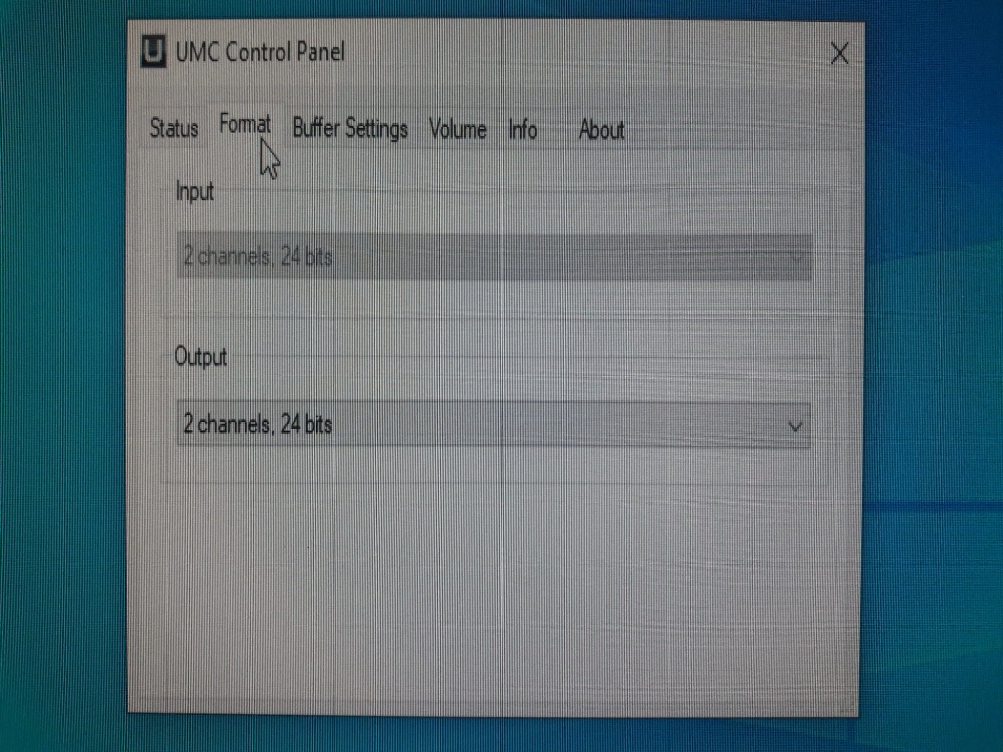

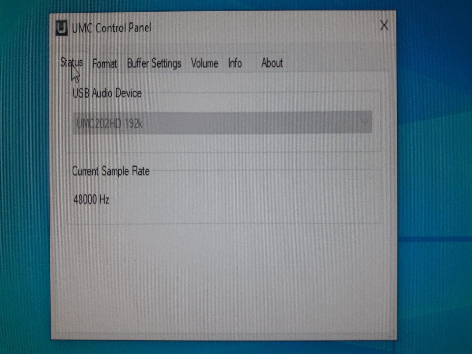

Hi Jim Clark. I am sending you some screens from which you can get the information you ask for. There is no word "Audio Frame Size" but perhaps one of the indicated parameters corresponds to it. The Behringer USB interfaces of the HD series (202, 204, 404) allow a latency of 4.2 ms only if you use the specific drivers that are downloaded from their site. If you use other drivers in WIN, like ASIO 4 All for example, you don't get the same low values. And the same thing evidently happens with Core Audio which is not a specific driver. The problem is that Behringer has created specific drivers for Win and not for MAC. For MAC they say there is no need to install their drivers because Core Audio is enough. They forgot to say that however you do not get the best possible performance.
Hi Gibelma - thanks for the screen shots of your ASIO setup. I am no expert on this, but I see your sample rate is 48,000Hz and the buffer size is 8 samples (very low I believe). I tried to mimic this on the Mac. In Applications-Utilities-AudioMidiSetup there is a setting for the clock rate - this defaulted to 192,000 when I first started, and gave very poor latency (35ms) - it can be set to 48,000 (snapshot 1). In JamKazam - Audio Gear Setup it recognized the UMC404 and calculated an audio latency of 9.29 (snapshot 2). Then go into Jamkazam and start a test session, and go to Manage-Audio Settings-Audio Booster and adjust the Audio Frame Size (my default was 2.5ms) to the lowest value (1ms experimental) (snapshot 3). Then back to JamKazam main screen and highlight the detail circle : I now show an audio latency of 6.3ms
I know that is still not the 4.0 you are getting with Windows - but it is better than the 13 (or 35) that I started with.
