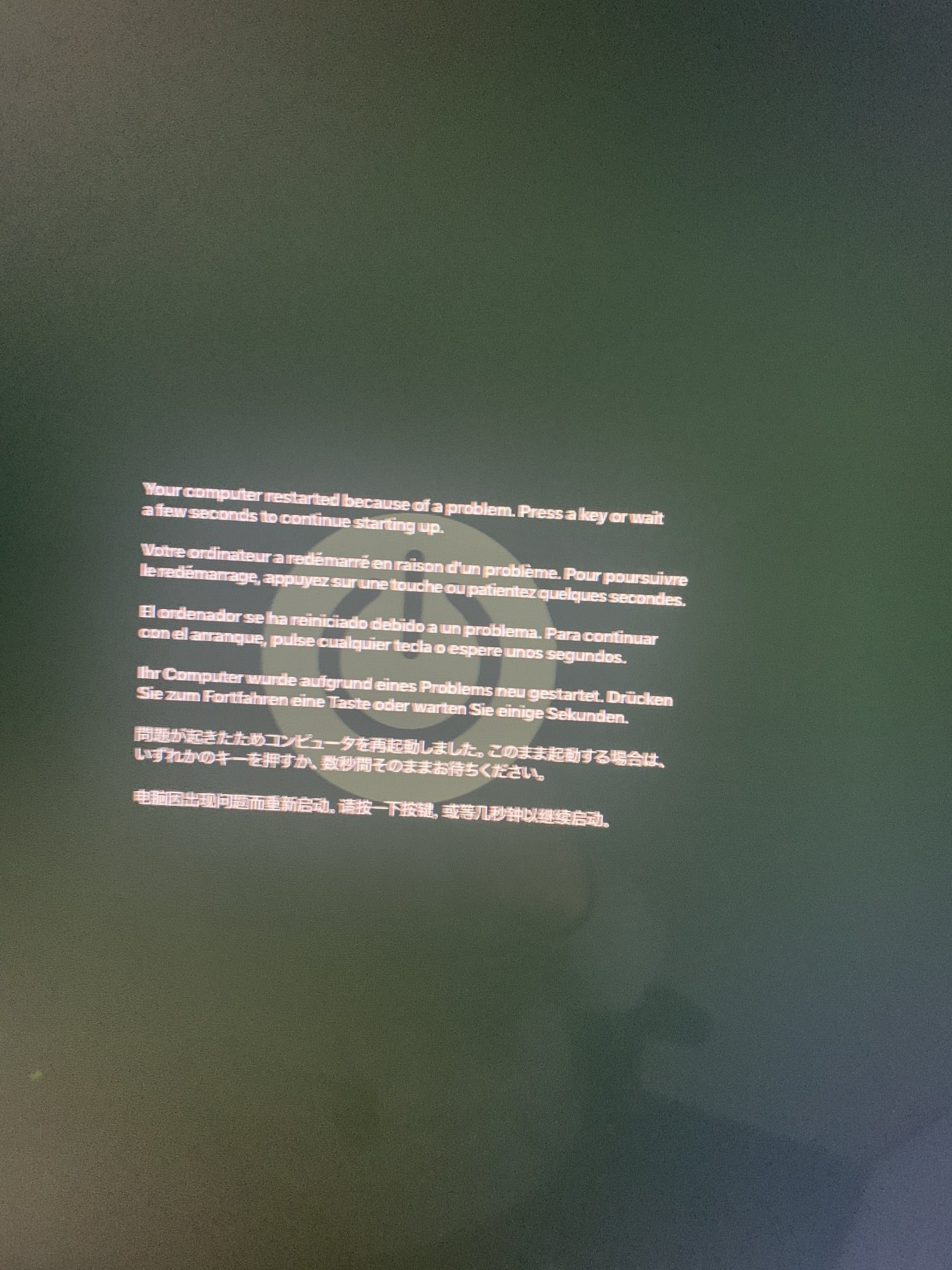

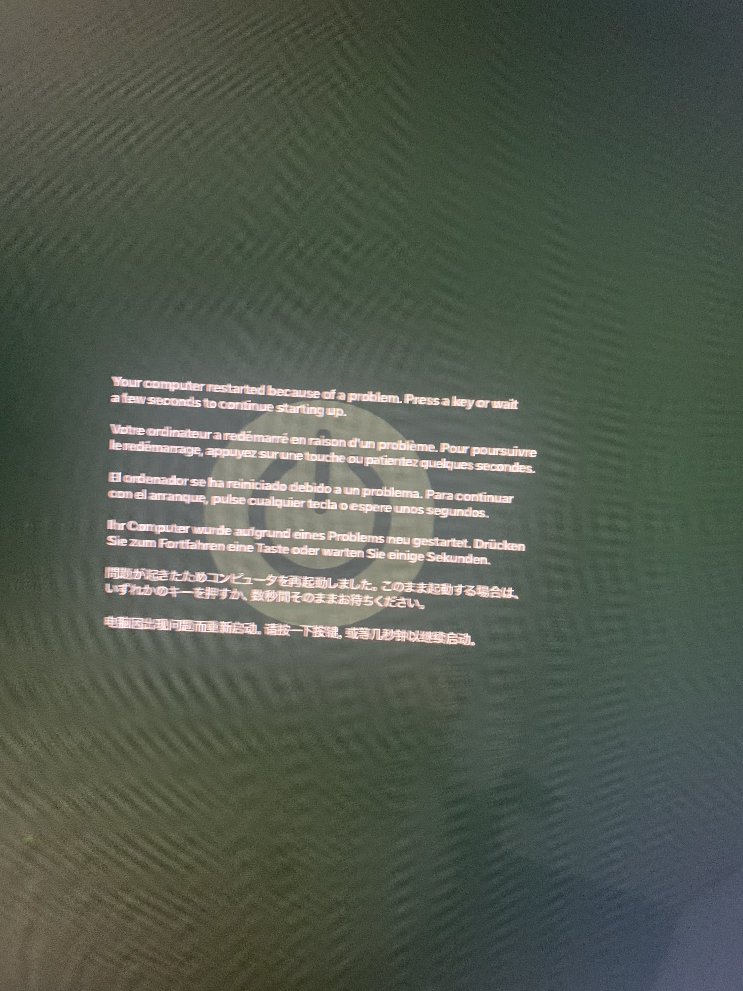

Hi Mike,
Thanks for your tips. As I have described above I have tried almost all methods you have introduced. Black screen doesn't mean complete black without txt but this restart message like in the attachment.
BR

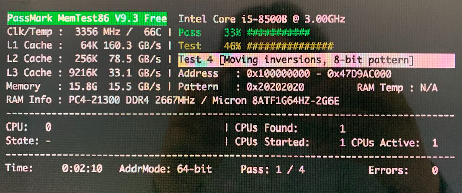

Update : Memetest86 result is also clear. (4/4 Test took about 3 hours.)
