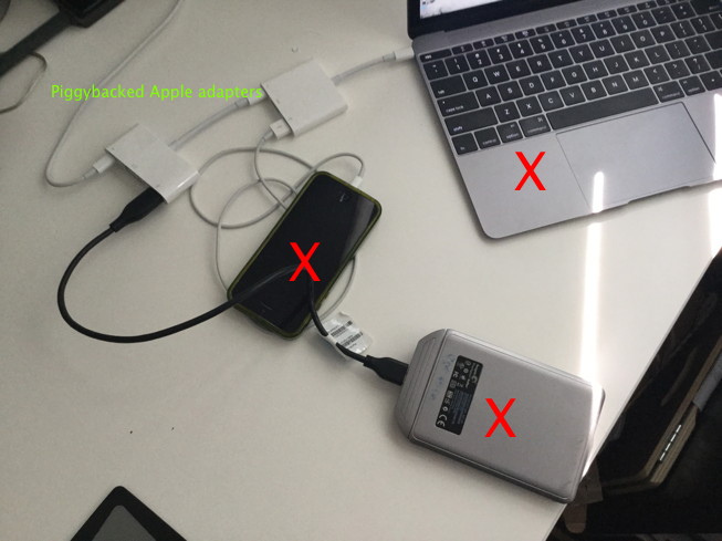

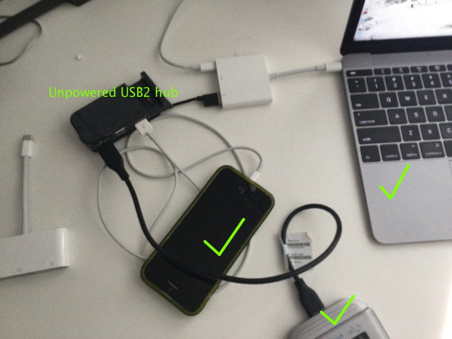

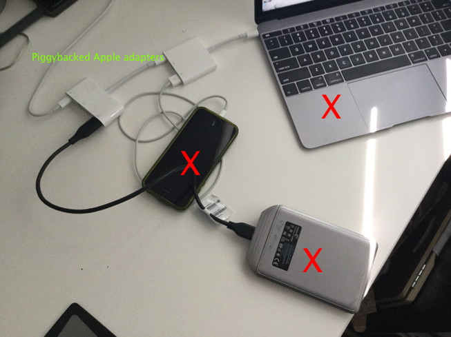

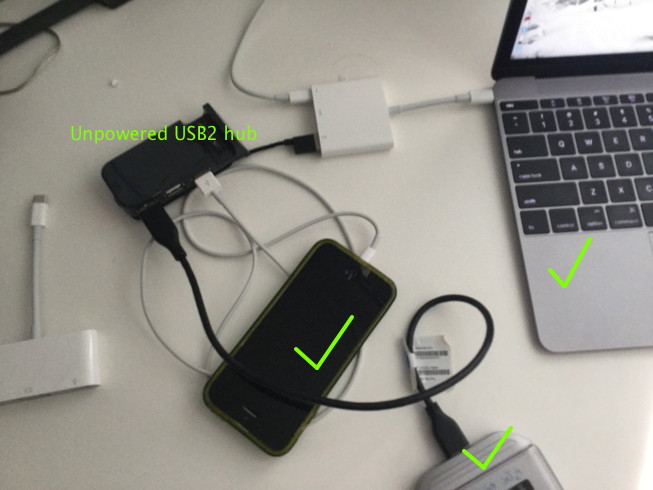

OK - I now have my 2 Apple USB-C adapters and they cannot be piggyback. The rMB and iPhone show not charging and the USB drive is not recognised
An unpowered USB2 hub works fine when plugged into a single Apple adapter.
So it look like I have have to carry around a USB hub as well as the adapters 🙁
