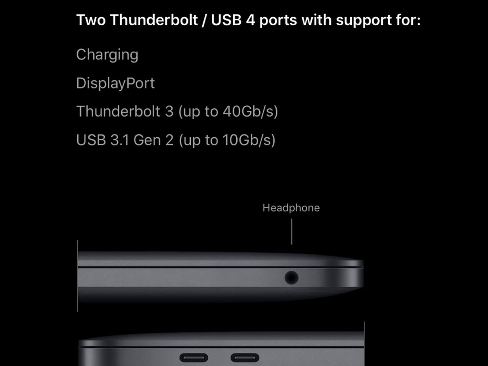

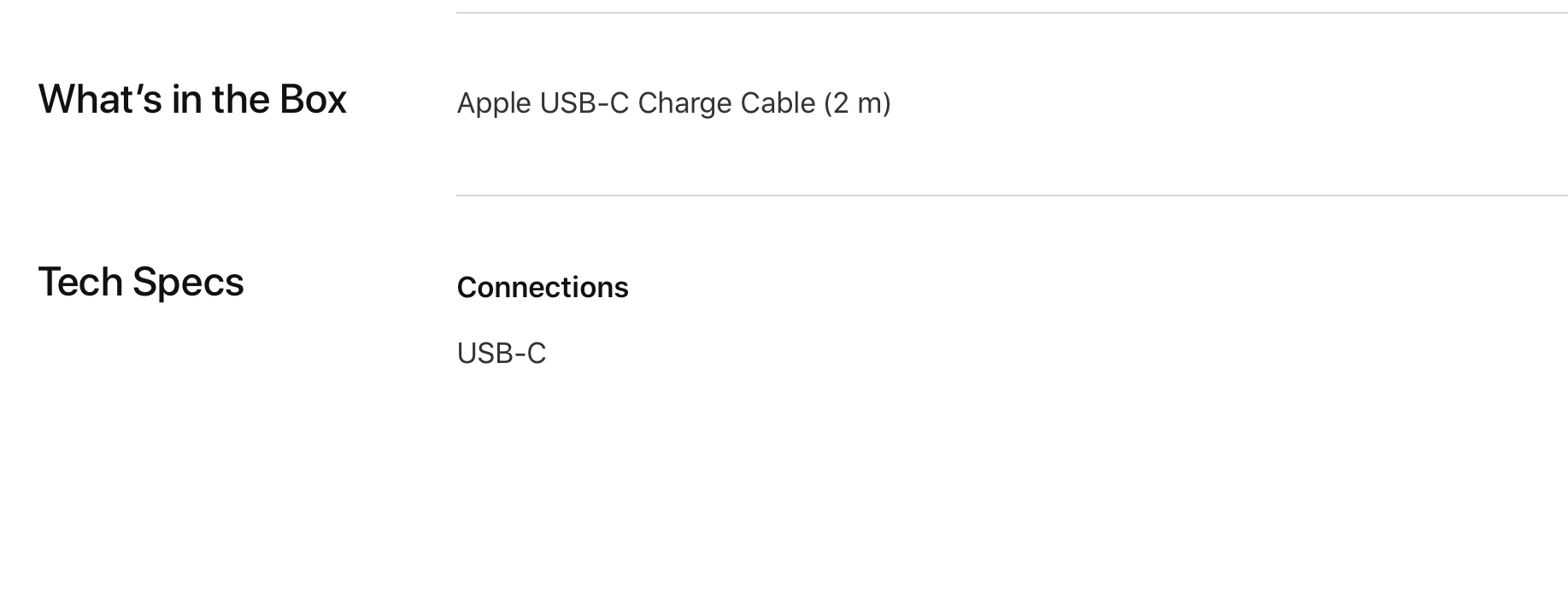

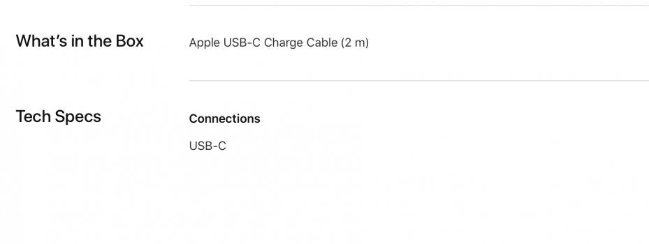

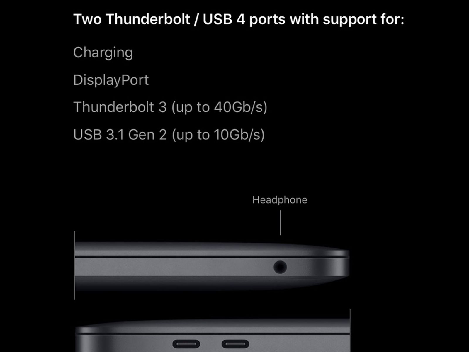

Imo Apple is not making it any simplier. Specs feel really vague from what I have learned.
