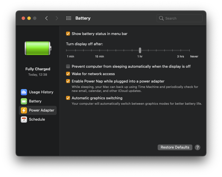

1. Does it make any difference if in Preferences/Energy Saver you set "Prevent ... from sleeping" is checked and "Put hard disks to sleep ..." is not checked?

1. I don't have Energy Saver, only Battery. I am usually using the computer when it happens so it shouldn't be going to sleep. Like I said, it even happens during file transfers.
