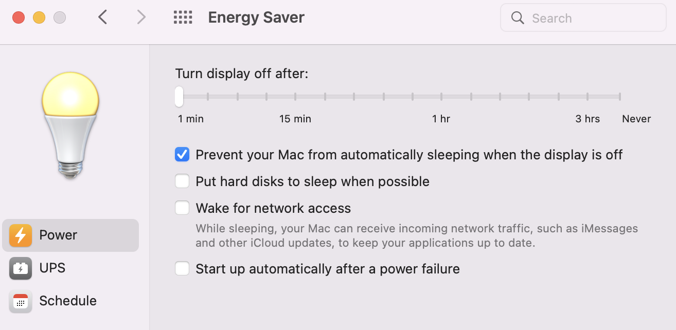

Put hard disks to sleep is not checked?

I no longer have access to the Energy Saver preference pane for some reason...and besides, my understanding of that setting was it is for computers with internal HDDs, not SSDs. It's been around for over a decade.
Dunno if it has any effect on internal SSDs, or whether it not showing in energy preferences indicates a problem. Works with external HDs though.
