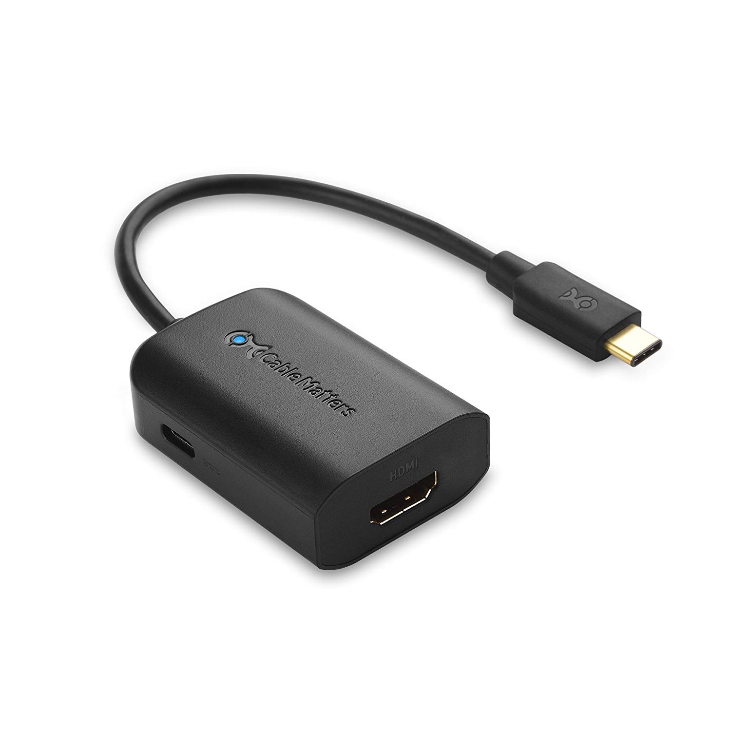

I personally have a multi-function hub with HDMI that does 4K 30 Hz (or 1080p 60 Hz) plus USB 3, and a separate HDMI adapter that does 4K 60 Hz with no USB at all except for a USB-C port for power delivery only.

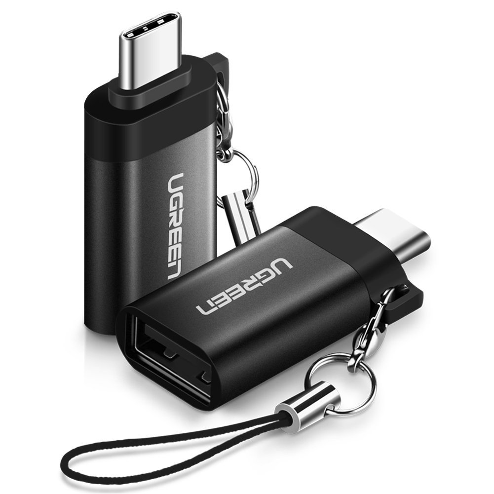

In the end I actually only rarely use my multi-function hub. What I really need is just a USB-C to USB-A non-powered adapter for occasional use with USB drives (and I keep one on my keychain with me at all times), and then separate VGA and HDMI adapters for when I give presentations. I only very rarely need video and USB at the same time.

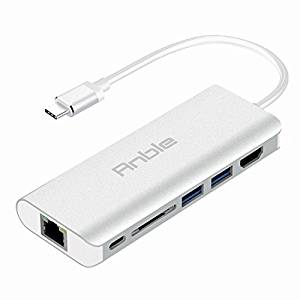

Ejecting connected devices or other problems when using other devices is a common problem with these USB hubs, even when power is connected. I have the same problem with my Anble multi-function hub. But like I said, I almost never use this anyway for the reasons mentioned.
So, while I have this, I rarely use it:
Instead, I just use these as needed:
