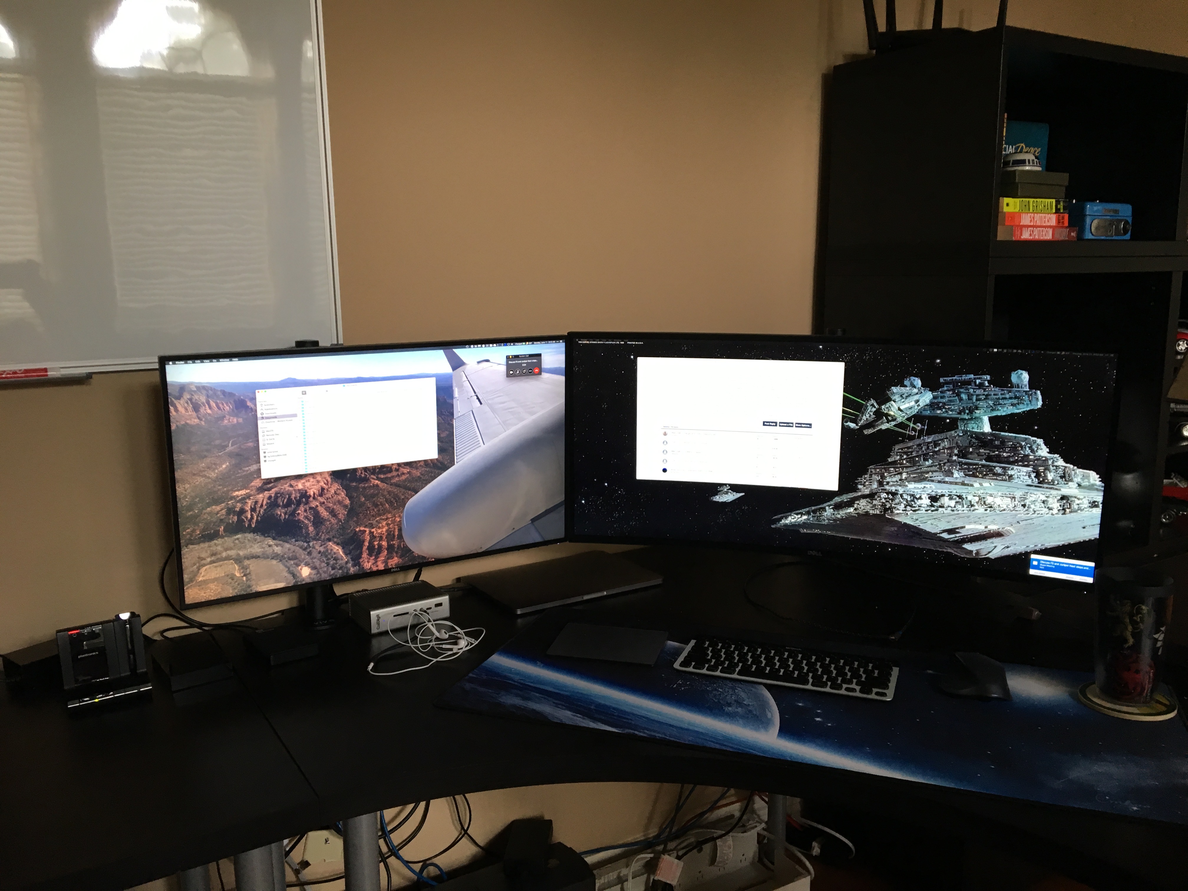

One thing I wanted to point out. From your "base model" comment above, I assume you purchased the non-Touch Bar version, correct? If so, be aware that you only have two USB-C ports on the machine. If you were to purchase the ‘K’ model of the Acer monitor you mentioned above, you would use one port for power and the other for the monitor, which leaves you no open ports for other peripherals. Be aware of that as you are shopping for accessories and add-ons. I would recommend that you look for a monitor with built-in power and data, such as the LG 27UD88 or the Acer ‘U’ model I mentioned. You could also consider an external Thunderbolt 3 dock like the CalDigit TS3 Plus+ or perhaps something cheaper like the Cable Matters TB3 Dock. FWIW, I purchased the CalDigit TS3 Plus+ and am very, very happy with it. Clamshell mode works perfectly with two external monitors (34” Dell Ultrawide and 27” Dell 1440p), a Logitech keyboard and mouse and Magic Trackpad 2 via Bluetooth, two external USB drives, and a Plantronics wireless headset for conference calls. All of this is connected via a single cable to my 2017 13” tbMBP. See the pic below for my setup.
It is all going to come down to how you will use your MBP, which peripherals/connectivity you need, and your budget. Plan out your workflow/workspace to determine your needs and do plenty of research about the products that fit those needs and you should be fine. Good luck!
Reactions: cman-uk
TLDR: I prefer the OWC thunderbolt 3 dock. It's expensive and annoying to have to purchase it to replace my dock-free setup with the older laptop design *but* it seems to be the least unreliable option.
I've been using the 13" without touch bar in clamshell mode for a while now (dual monitor, BT keyboard and trackpad, a bunch USB-A peripherals). I've been through most permutations of dongles. Everything is flakier about this laptop than the previous generation. Some dongles work, some don't, some seem to have a way of causing the thunderbolt ports to stop working (including for charging) until SMC reset. Rebooting with the desired dongles attached at boot time seems to mostly resolve issues. The forums and internet are alive with advice to "use this magic cable" to fix your <fill in the blank flaky display/thunderbolt/usb-c> issue. I've tried all the cables. Nothing will work in the long term, the ports are just flaky (I'm hoping fixing that is why we did not see new laptops at WWDC).
If that sounds overly bleak, don't worry too much, just reboot when you attach to your monitor/ethernet set up and live happily until you move the laptop.
