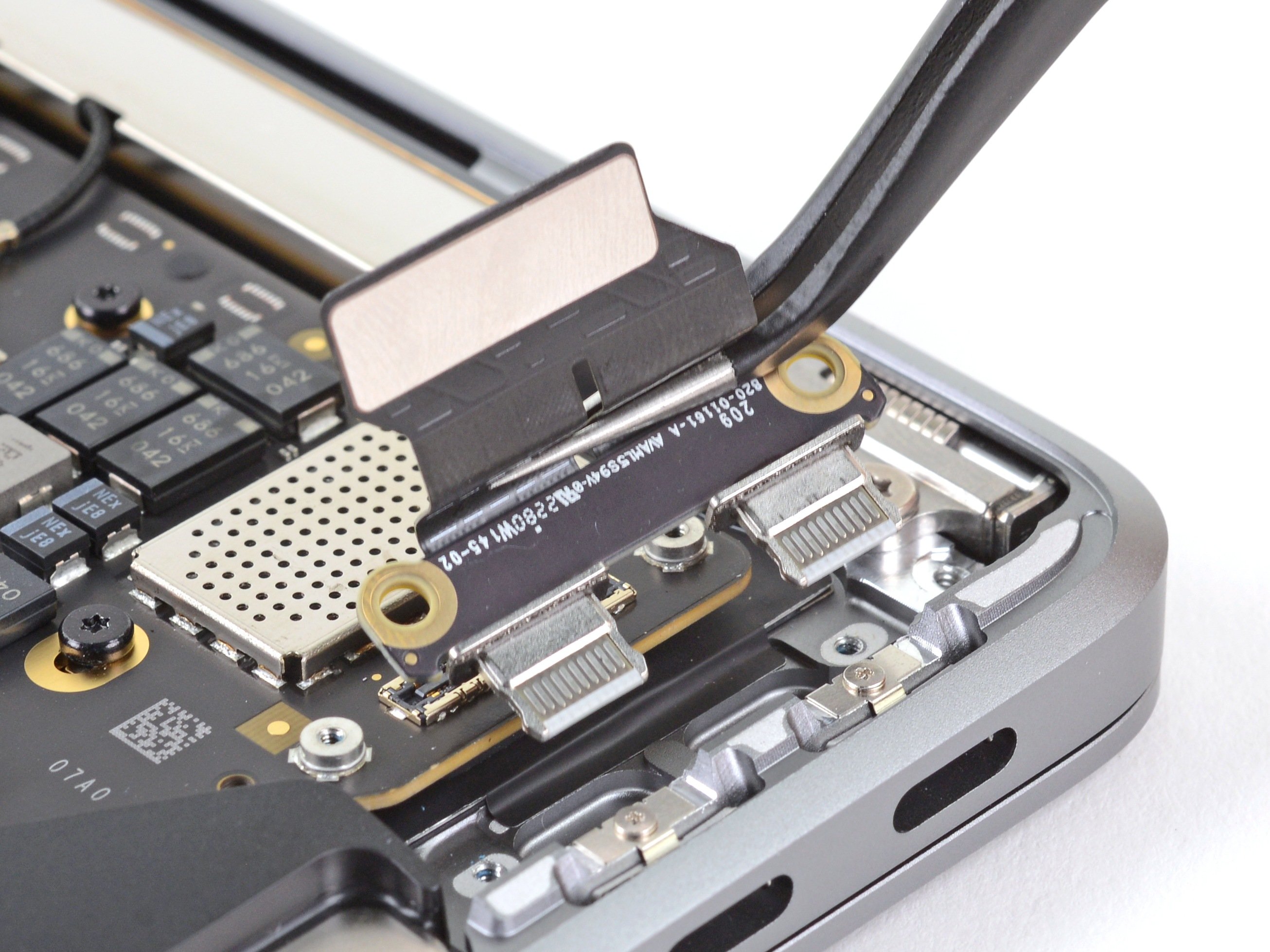

Found this on ifixit. Looks within the realm of my capabilities - I remember replacing an iPhone 4s battery on my own back in the day and this looks comparable. $50 for the part and tools seems worth it to me before giving up. What do you think?
I have no idea if that will fix it or not, but that's a great step-by-step that doesn't look too difficult if you have some proper tools. Good luck, and sorry to hear this issue is even happening to your M1 Air. We all may be next.
Yeah - I bought exactly what iFixit linked from the directions...Came to $55 with shipping...worth a shot. Really ridiculous of course that we even have to do this. :(
I think you made a great choice. If it works you'll save a lot of money compared to what a certified tech service would charge.

Just sharing good news... just confirmed with the card benefits customer line for my Amazon chase credit card I bought it on extends my warranty an extra year :) So I'll bring it to the authorized Apple repair place in town and get it fixed! I'm going to hold onto the port and tools coming from iFixit since I suspect I'll be in this position again within a year!
Well - to end the story positively - it was indeed the USB port replacement that I found as an option on iFixit. The local place charged me $173 which the credit card company will pick up. Frustrated that this happened, but good to know that it is likely a repair I can do in 10 months when my warranty is up, and if it happens again. I'm holding onto the port and tools I got from iFixit for if/when that needs to happen again.

I went to the apple store with this problem, and the price to fix would have been $500. The part costs $26, but it's fiddly to plug back into the logic board, and my fix didn't work. I saw someone else say that after sending it out for service, they had to send it back to replace the logic board. By the way, diagnostics do not show anything, and the apple store person said that was normal for diagnostics not to show this.
