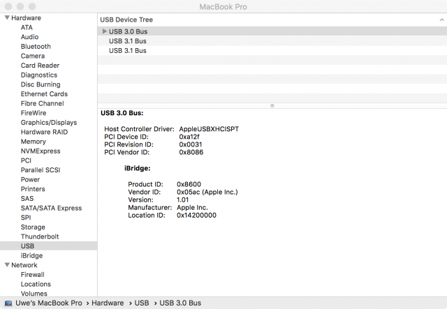

I also noticed that the system report is showing only three USB bus, but I don't know if that is normal or not:

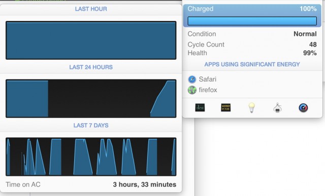

Interesting is also the iStats Power usage display for the last 24hours. As can be clearly seen there was no usage for about 10 hours or so. That was the time the MBP was on sleep during the night. Still the battery was at 100% when put to sleep and about 4% this morning:
