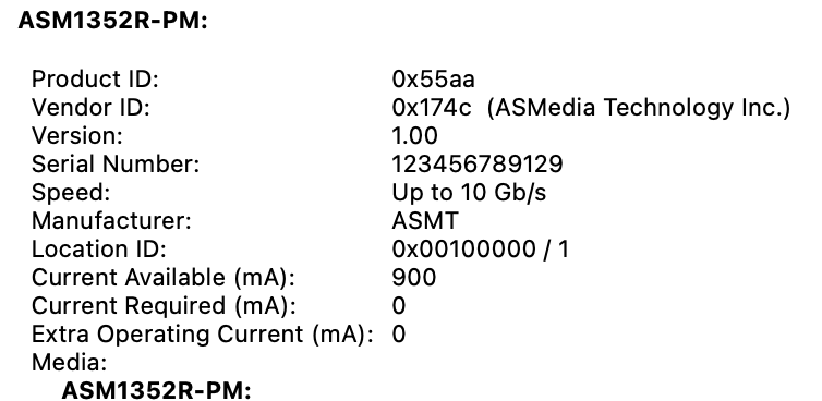

I have a 2019 i9 I Mac currently I have a Inateck FE2101 dual 2.5 HHD enclosure with 2 SSD's (1TB & 2TB). I the system overview the case does not report back the electoral current used. Looking over the power requirements for the SSDs it seems they will draw more power that the 900mA my 2019 iMac can provide. Is there a way I can measure how much power this unit is drawing. It does have a 5V dc input but when I hook it up the computer will not recognize the drives.

This spec is for a USB-C port. What type of USB port are you connecting the drive to on the iMac? As you mentioned 900mw I assumed you were connecting it to a USB-A port. As per the page you linked, you can use the System Info tool to check what wattage the port you're using can deliver.
I am using the USB C port, however system profiler only shows 900mA available,
