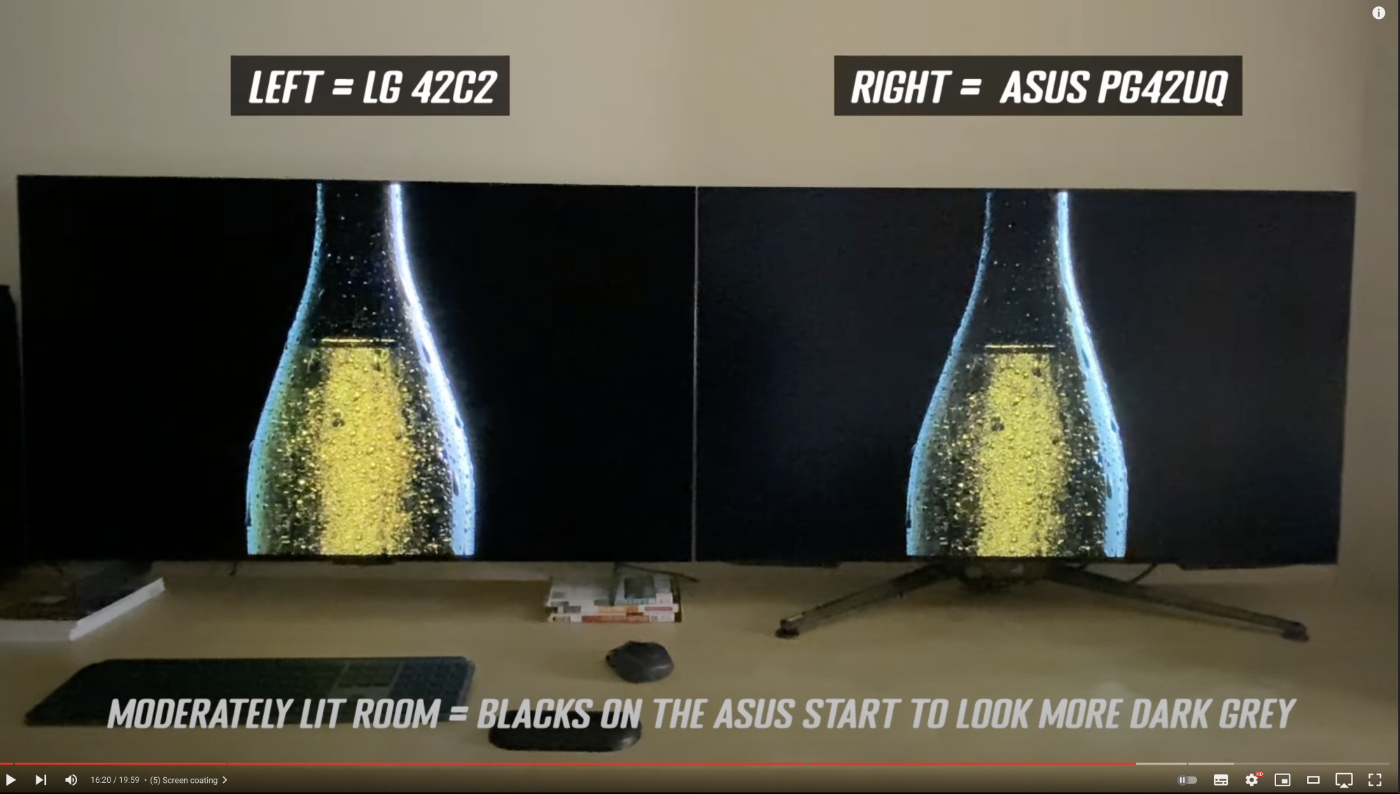

Really Nice did not seen them !! It has DP so Connection works perfect ! But I Pay only 720€ for mine 42 OLED and the ASUS Cost 1700€
Did see that it have an Anti-Glare which I do not ike because the Blacks and Contrast a l lot less good as the LGs. :/

Yes, I looked into using TVs however for myself I preferred to get the monitor. I can control the light levels in my room very well, so I’m not really impacted by the greying. It is my gaming PC and PS5 display… no movies or other uses.

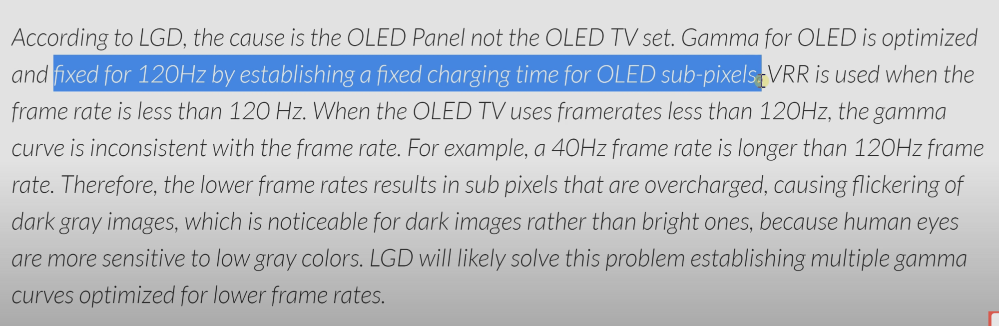

The Black Color Flickering under 120hz is a problem which all have when HDMI 2.1 is used. Its a Bug with HDMI 2.1.
When u have a TV/Monitor that only support 60 hz then u will not have this issue. But when u have a 120hz Panel and run it with under 120 hz or VRR under 120hz u will get this issue. This is what I have ben informed now after reading days about this issue. Also LCD have this issue but u will not notice it there like on an oled. This is why we need the Game-Optimizer on LGs
He mentioned it can not be fixed by Software:
He say this also:
He say this also:
It is not a bug with HDMI 2.1 but with the specific LG OLED panel design. To solve it they need to do something differently with their panel or its controller, thus no software fix is possible.
Again, this really does not show up unless quite specific conditions are met. My understanding is that LG even added a black level brightness slider option to the OSD to combat especially this.
