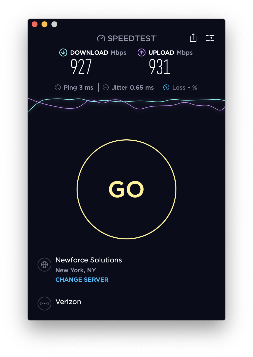

Feels like something is wrong with your computer… I get full speeds with my adapter:
All plug and play.
I used a 2016 15" MacBook Pro to run this test.

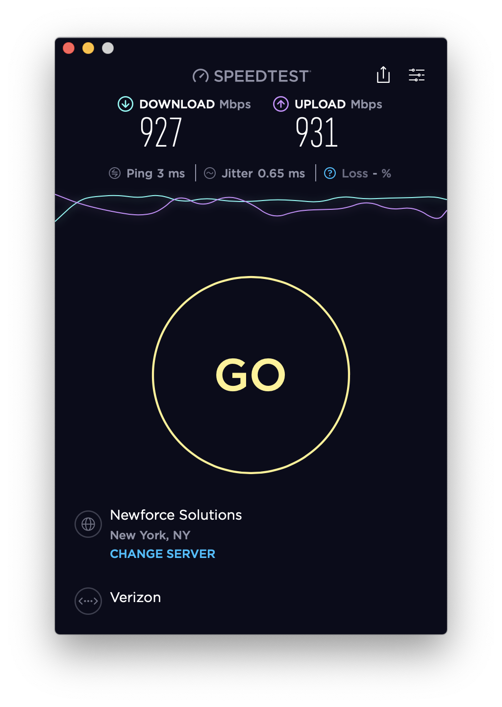

All plug and play.
