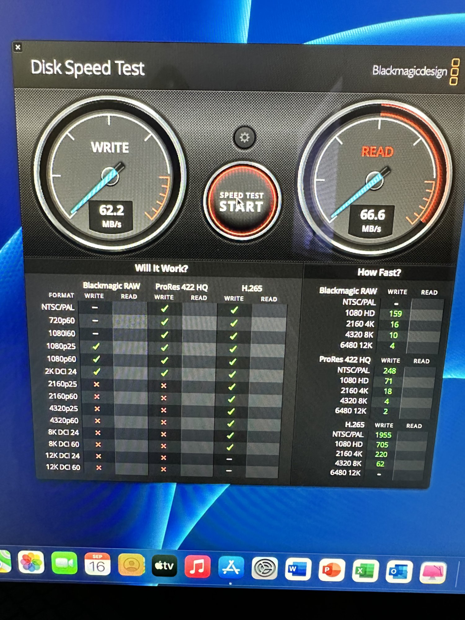

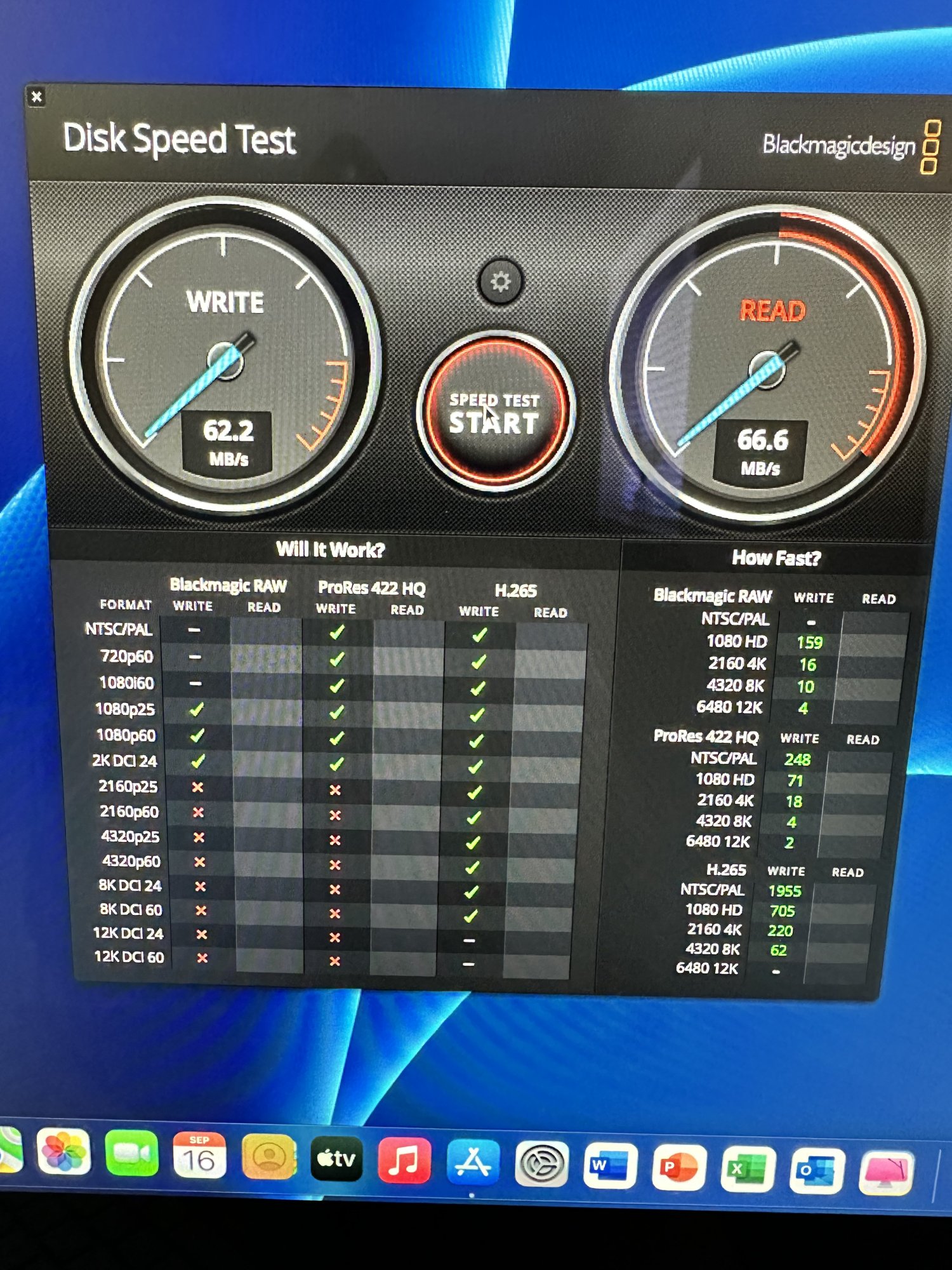

Hi all, I have installed macOS onto a crucial X9 pro SSD in an attempt to speed up my late 2015 Mac but the speeds are ridiculously slow, it seems slower than the internal HDD. I asked on here and was told it could possibly be the usb c to usb adapter that I am using as my Mac does not have usb c or thunderbolt ports.
Could anyone recommend an adapter that would improve my speeds please?
I will attach a pic of the speeds I am getting and the actual adapter I am using
Thanks

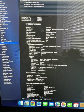

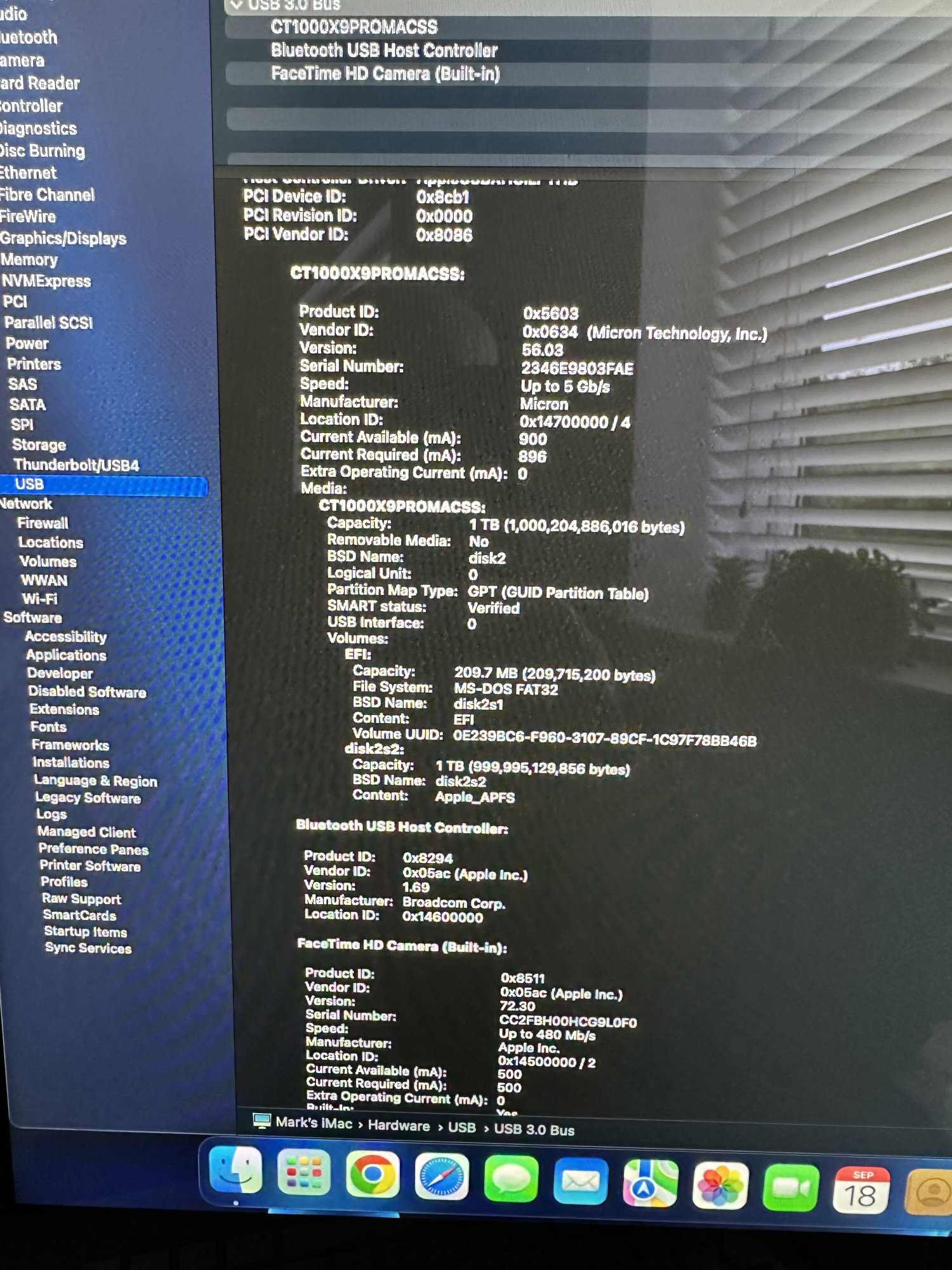

It recognized at 5Gb/s so cable and adapter not problem it seem. This screenshot while booted from external?
No buddy, I unplugged the external to boot as it takes longer to boot. Once on desktop I plugged the drive in.
I’m at a loss as to what’s actually wrong!
Although the connection does seem fine, some additional thoughts:

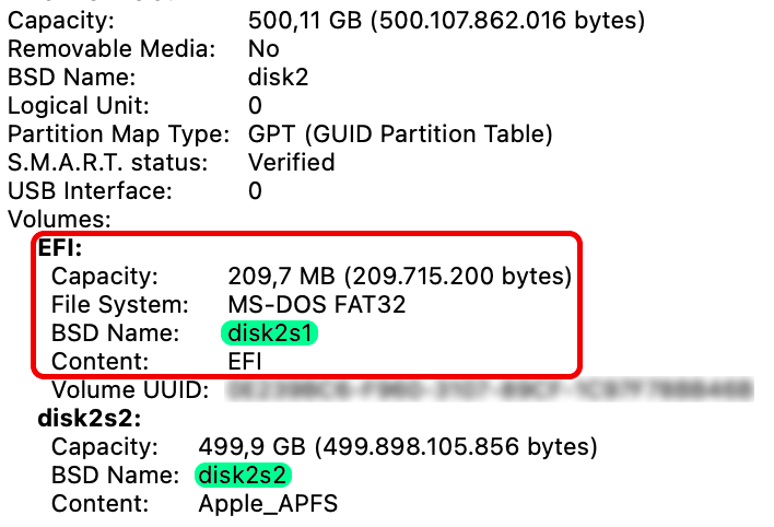

However, looking at the above info, I noticed this:
Seems to me that "MS DOS Fat 32" should NOT be there.
So... here's what I suggest:

Just one thing I have done, I used the black magic speed checker and the SSD was getting speeds of around 400 so it’s not a faulty SSD
No, it must even be there.
That's the EFI partition disk2s1 of the APFS volume disk2s2 in OP's screenshot.
I am not saying that re-formatting is not worth a try to rule out any problems but if anyone goes through the steps you describe, it will look exactly like it does now again. Or by simply formatting the SSD via 'Disk Utility' as OP has a working operating system on the internal HDD of the iMac.
