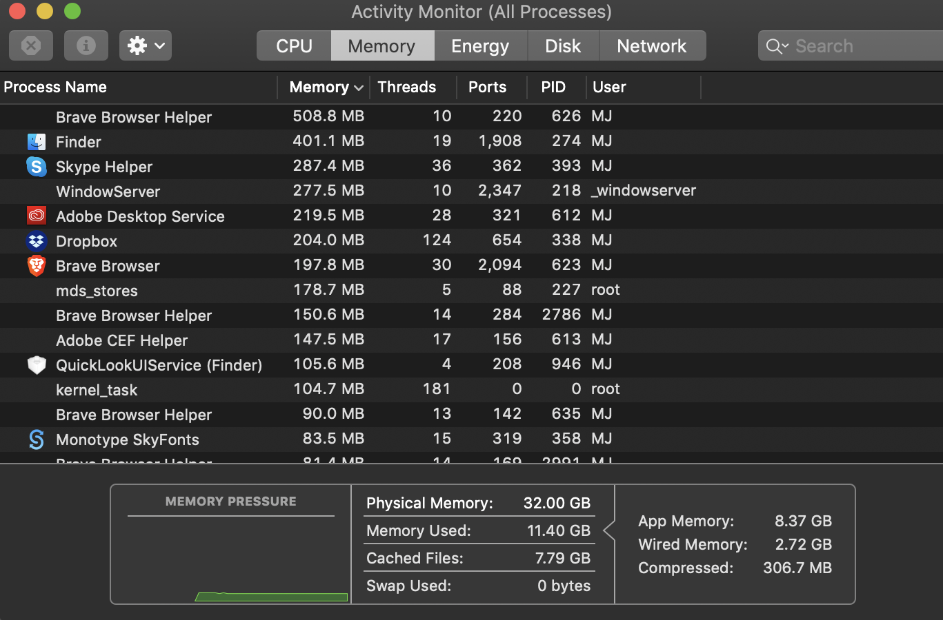

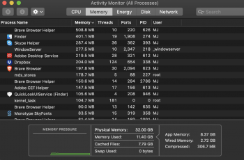

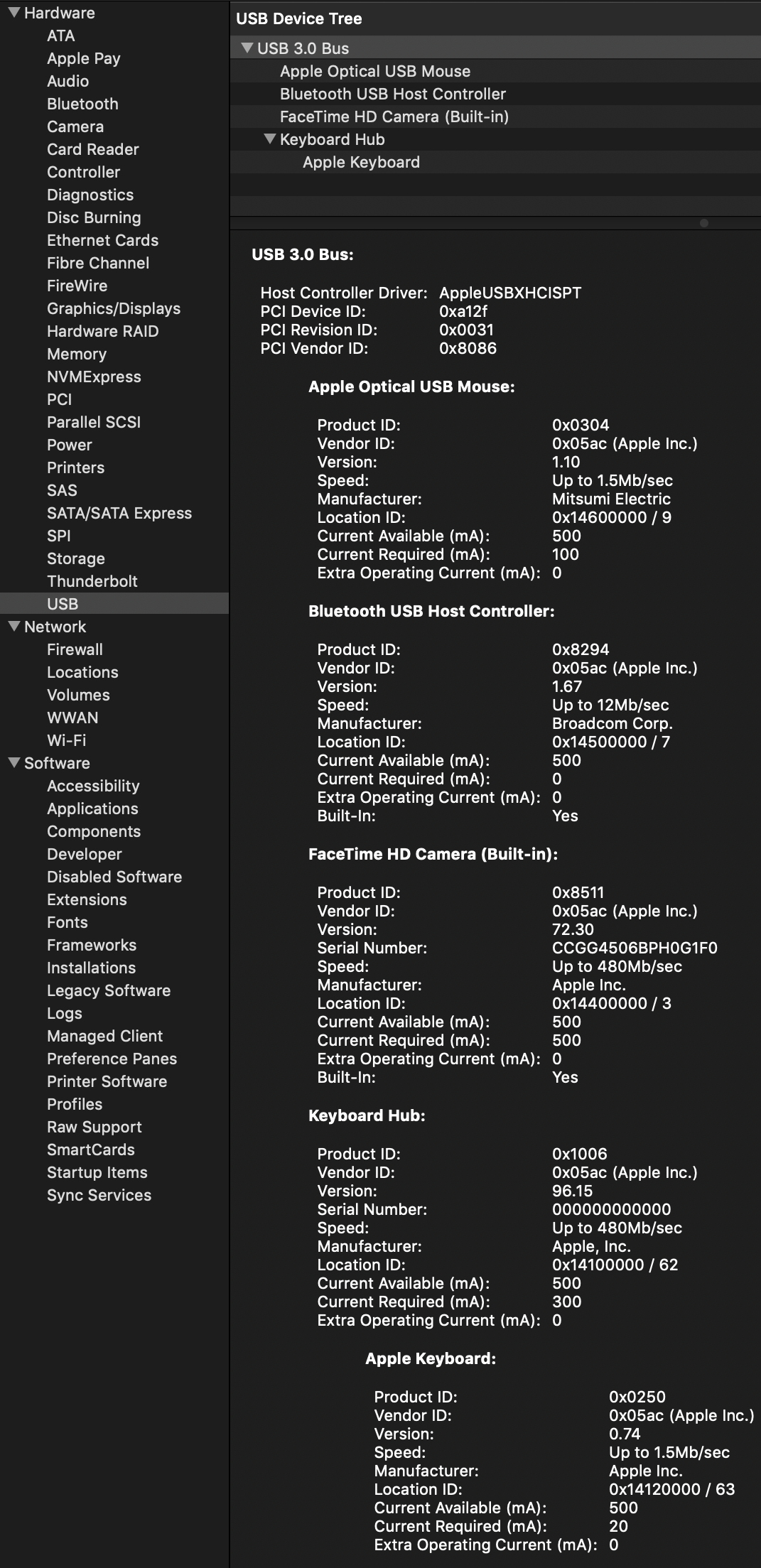

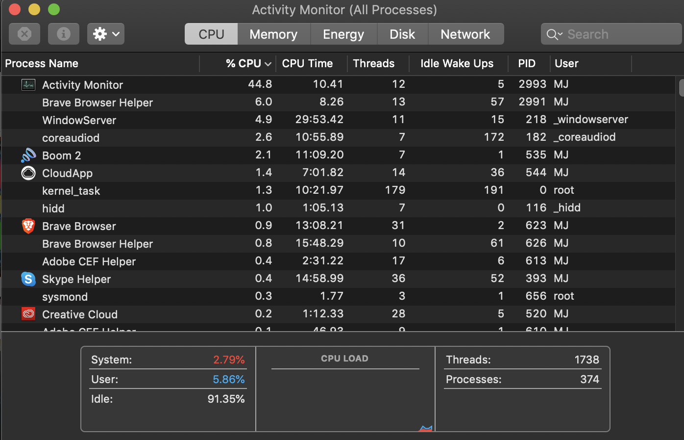

Attached are some screen shots of the USB section of the System report and from the Activity monitor (if that helps).
