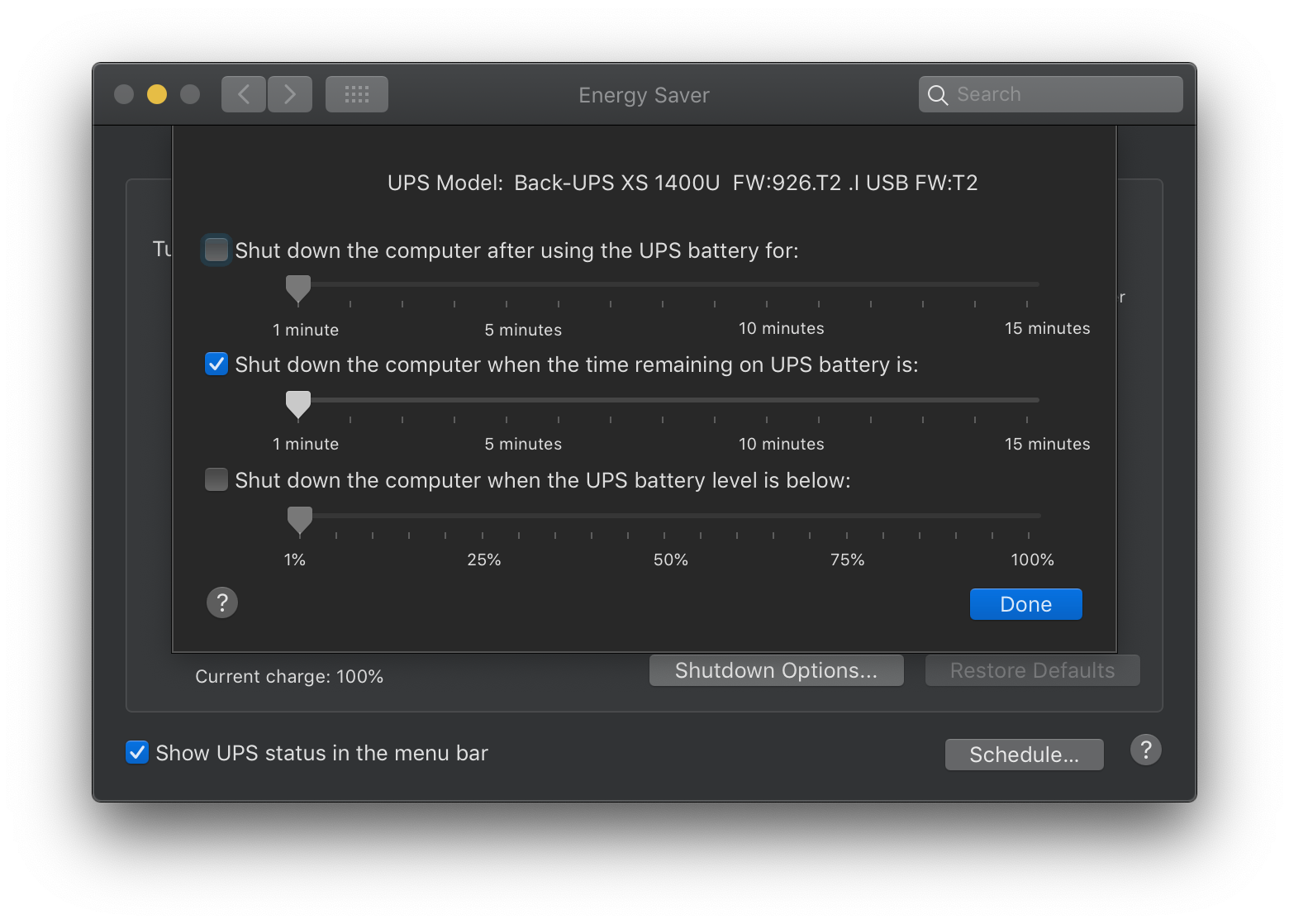

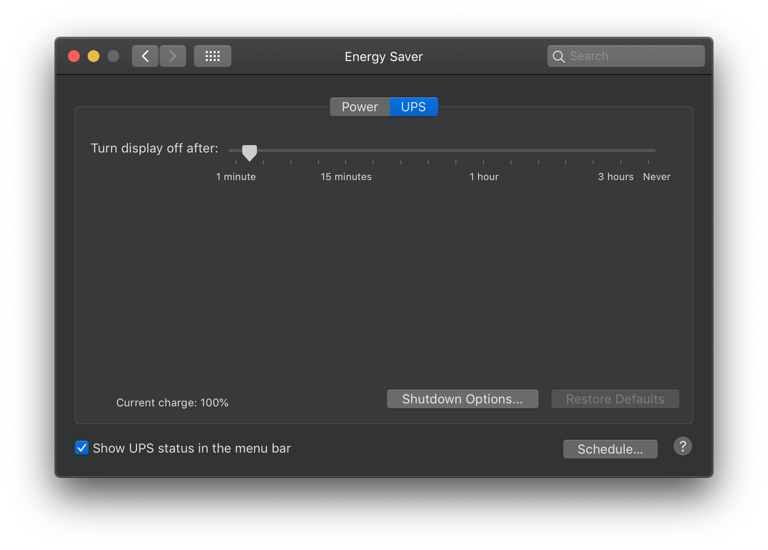

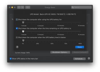

Do you actually need the software?
I'm using an APC UPS and it's just detected by macOS automatically.
Screen Shot 2019-07-30 at 19.02.31.pngScreen Shot 2019-07-30 at 19.02.36.png
Yes. The Mac OS does not detect this UPS. I had high hopes, but they were soon dashed. Nothing in the Energy Saver panel.
