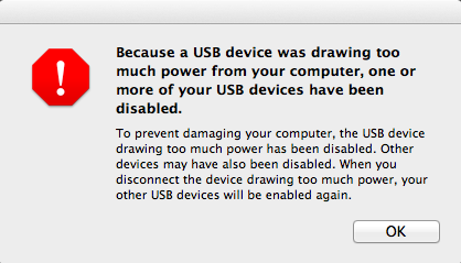

I recently tried to plug my printer into one of my macbook pro usb ports and I'm getting a message that reads that the USB is drawing too much power and the port will be deactivated. I'm very confused! I've used the printer before on the computer with no problem. I changed the usb cables out, I went and bought a self powered mutli usb hub.. that didnt work. HELP!

My new macpro laptop is doing the same thing - I get the message when I just plug in the cord even without a camera attached. Did you find out whY?
In this case, I would suspect a defective USB cable (what you call the "cord"), or a defective connector.
A plain USB cable with nothing attached at the other end shouldn't consume any power at all. It's just wires. If there's a short circuit in the cable, then that's a serious problem, and will lead to the error message.
The most likely solution is to use a different cable. If that one fails, too, then maybe the problem is in the computer's USB connector. You'd have to take it in for service to know for sure. If you do that, you should also take the cables that are failing, because you might just have multiple defective cables.

For reasons known only to Apple, many (not all, but most) Macs do not supply enough USB "bus power" to support some external USB devices. Typically, if you already have a USB device or two connected (example: keyboard and mouse) and attempt to plug in -another- device (that requires USB power), you may get an alert that the USB bus cannot supply power to the device (and has been "deactivated", as said the message you received).
What's happened is that you tried to connect a device (or devices) that exceeded the aggregate ability of the Apple USB bus to supply power to all of them.

Just had exactly this problem with a Blumax GPS device on my new MacBook Pro. Tried it on my MacPro. Same problem. Tried it with a powered hub. Same problem. Tried a different USB cable from the one supplied, worked perfectly. So the supplied USB cable has gone in the bin.
