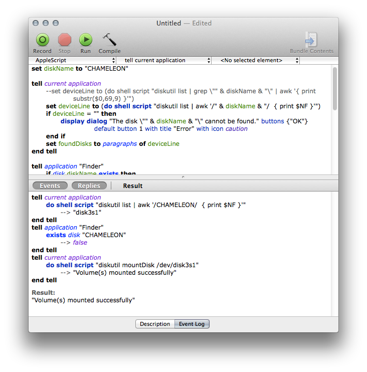

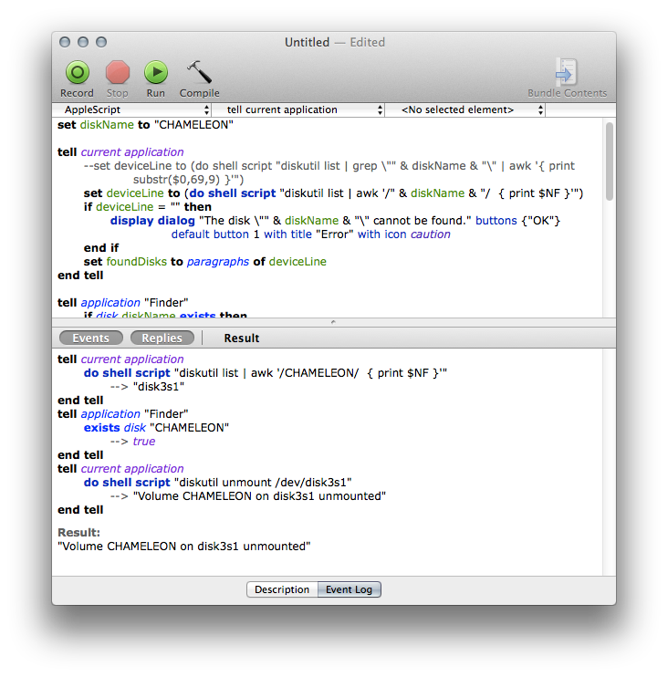

Use the script from nickv2002 from the first link and change diskname in this statement to the name of your USB drive as it shows up under Devices in the Finder :
Code:
set diskName to "diskname"
Also change this :
Code:
awk '{ print substr($0,69,9) }'
with a cleaner
Code:
awk '{ print $NF }'
Or this :
Code:
set deviceLine to (do shell script "diskutil list | grep \"" & diskName & "\" | awk '{ print substr($0,69,9) }'")
with this :
Code:
set deviceLine to (do shell script "diskutil list | awk '/" & diskName & "/  { print $NF }'")
