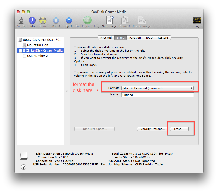

You don't need to install a driver for a flash drive. OS X should recognize it automatically. You can try erasing and reformatting your flash drive by plugging it in (even if you can't see it on your computer) and opening disk utility. Then you can click on the USB and erase and format the disk (probably as FAT if you need to use it with a PC as well) Just make sure you back it up first.
