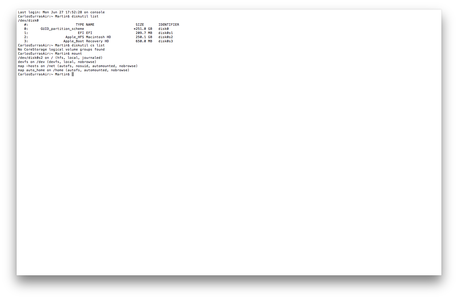

I have the same problem but i doesn't show up on disk utility it doesn't show up on windows either.
DOES ANYONE KNOW HOW TO FIX IT?
Shouting will not get a better or quicker answer.
Please share output from the following commands:
diskutil list
diskutil cs list
mount
If the USB flash drive was inserted at the time that you ran those terminal commands, then the flash drive is likely dead.
Have you tried other flash drives?
If other flash drives work, and appear correctly, discard that bad flash drive. No use beating yourself up trying to get a dead device to work.
