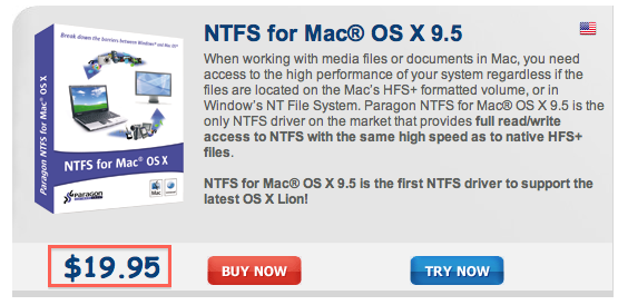

    • For Mac OS X 10.4 or later (32 or 64-bit), install Paragon (approx $20) (Best Choice for Lion)

On an unrelated note, I saw this and my desire to get it was completely gone:
People still use Comic Sans...?
