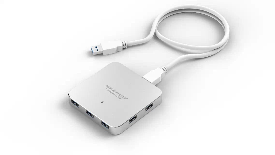

I received usb hub today
Wow i never expected that usb hub was so design
Its very beautiful, well designed, made in aluminium, in a word: perfect
It totally fits with Apple Mac universe
I am waiting for ethernet adapter coming tomorrow
