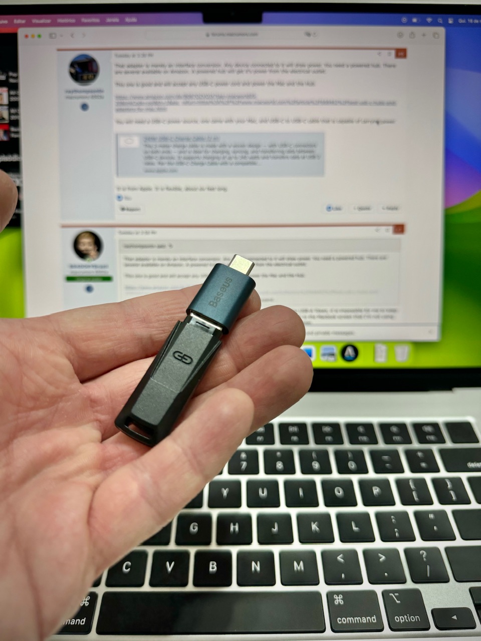

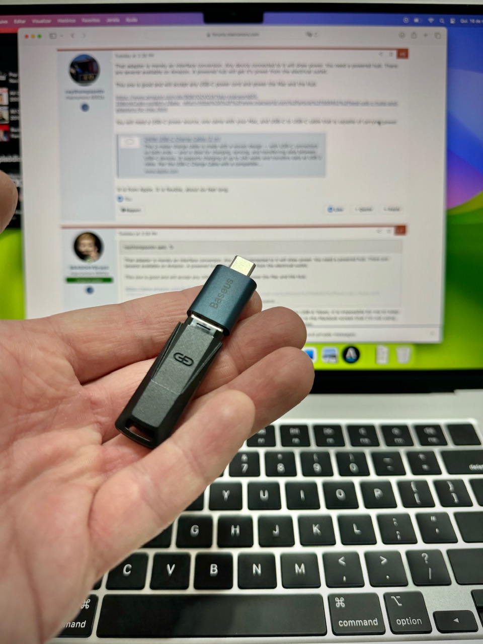

I bought this adapter for my USB Token:
Can you tell me if this type of adapter needs power and if it will drain my battery like the HUB?

My adapter has arrived. I'm going to test it, but I believe this adapter doesn't drain my battery like the HUB.

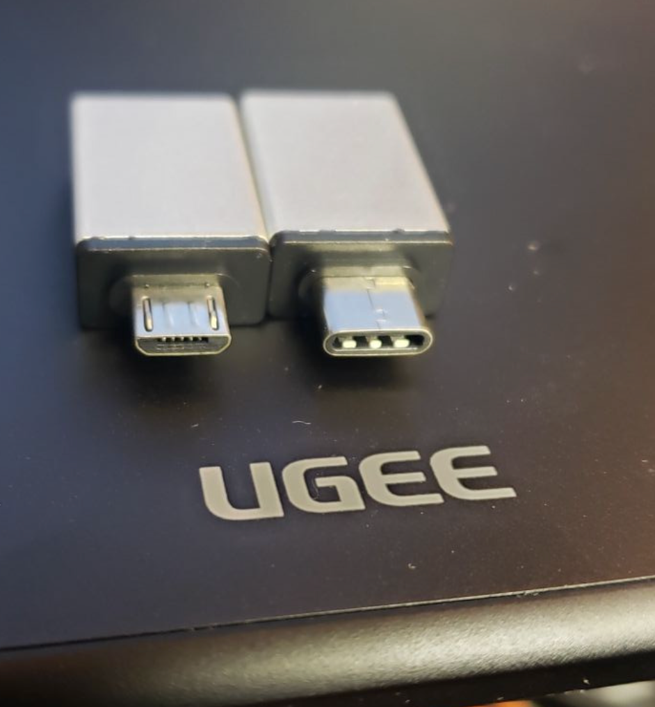

I'm kinda late, but I just noticed that when using a USB hub with an ethernet port, that my Mac was charging way slower than usual. I've got iStatMenus measuring how much power my computer is using, and atm I'm using about 15-18W (I'm downloading things at 70MB/s to an external SSD). I also connected a simple USB-C to USB-A dongle that came with a drawing tablet (UGEE S640)

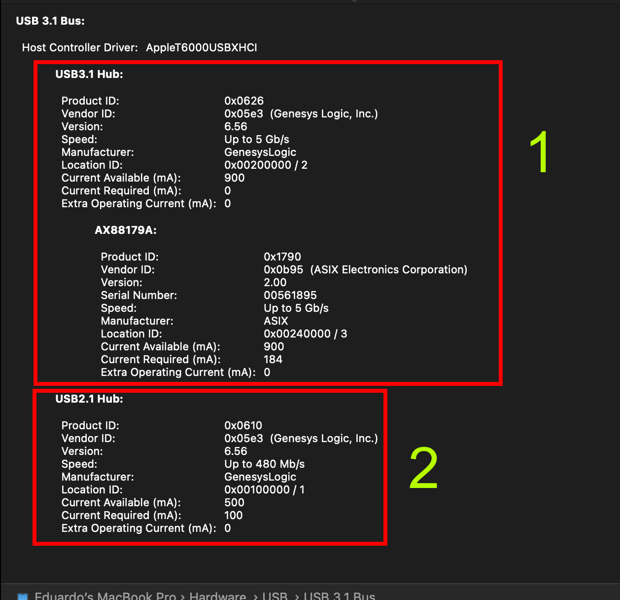

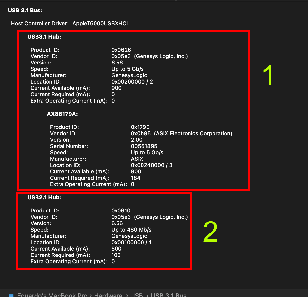

1- Ugreen 60600 (4 in 1, 3 USB-A 3.0 1 gigabit ethernet port) nothing connected to the USB-A's
2- USB-C to USB-A that came with the UGEE S640 tablet nothing connected to the USB-A (I've included an image of it, just a generic adapter)

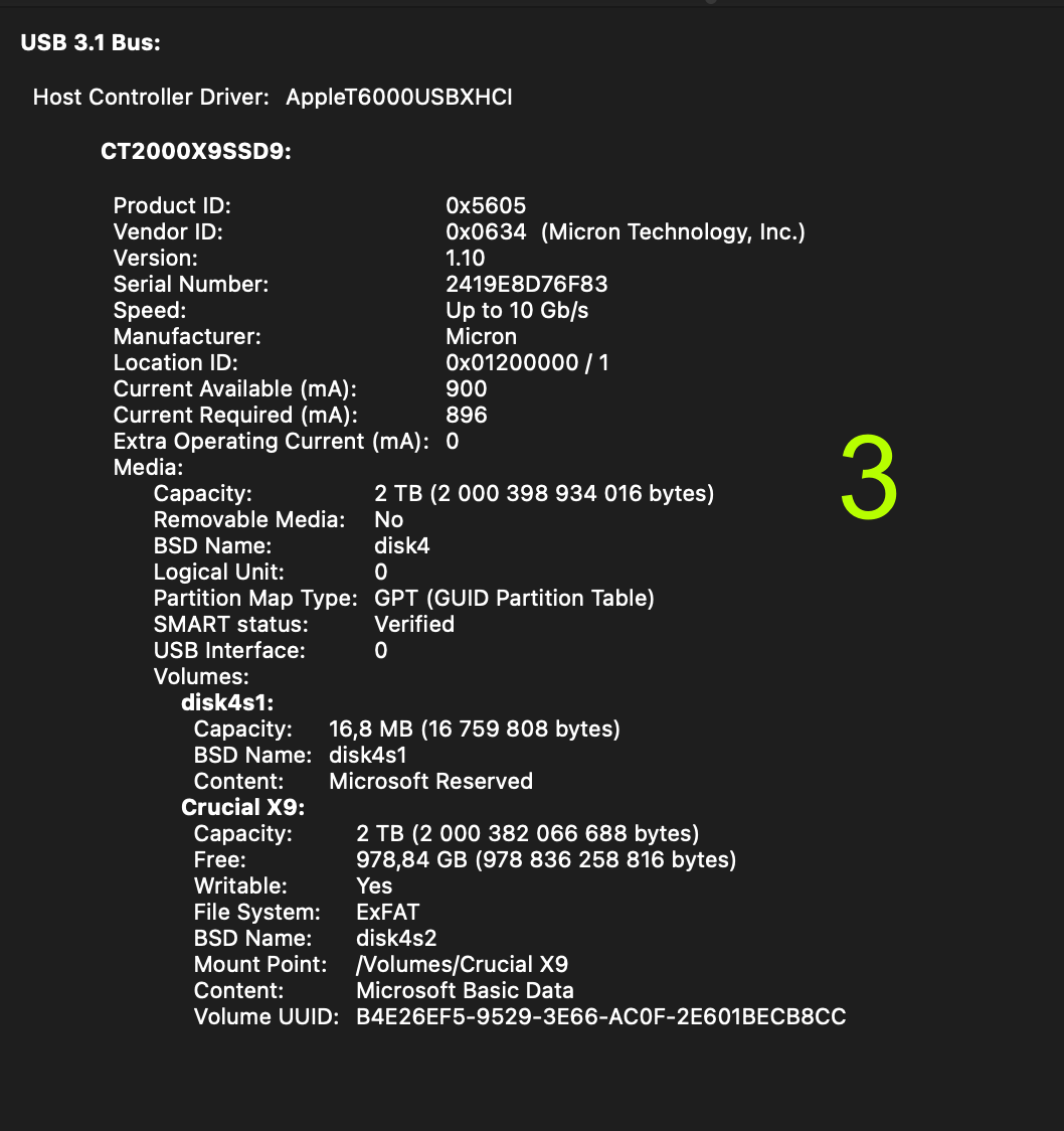

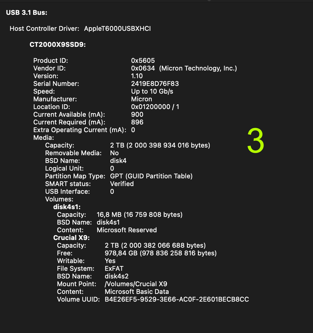

3- Crucial X9 2TB connected with the included USB-C to USB-C cable
From the System Report, I think the 4 in 1 hub only uses power for the ethernet port, and the 3 USB-A ports don't use any power.
The same can't be said for the USB-C to USB-A dongle thing, even tho nothing is connected on the USB-A side, it uses 100 mA (0,5 W) idling (maybe it's because it's USB 2.1 and not 3.1?)
Since I'm downloading multiple big files, I'm writing 13MB-50MB/s) to the external SSD, so it's using "a lot" of power.
