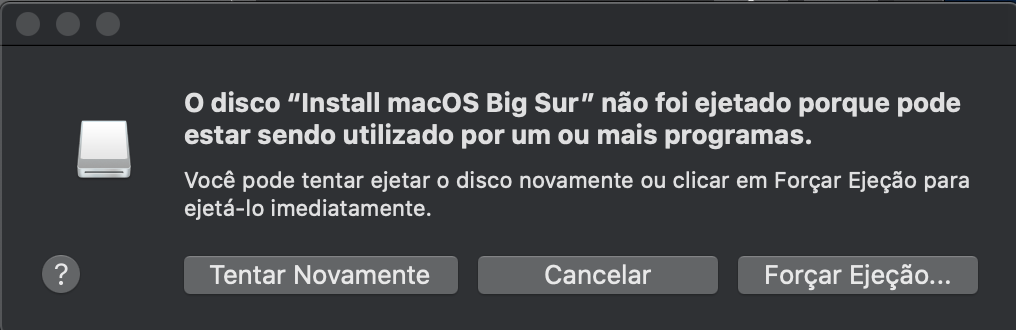

Anyone else unable to eject their USB drive after creating a Big Sur USB installer ?
Tried 3 different macs including one running Big Sur. All refuse to eject the USB - only way is to force eject.
"The disk "Install mac OS Big Sur" wasn't ejected because one or more programs may be using it."
Everything is closed. I can't figure out what could be accessing the drive after install ?

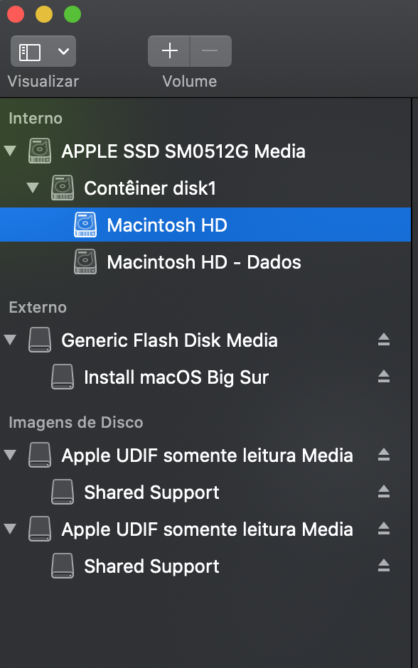

createinstallmedia forgets to eject two disk images named "Shared Support".
"diskutil list" will show the connected/mounted disks and disk images.
"diskutil eject diskX" will eject the image.
afterwards "Install macOS Big Sur⁩" can be ejected properly.

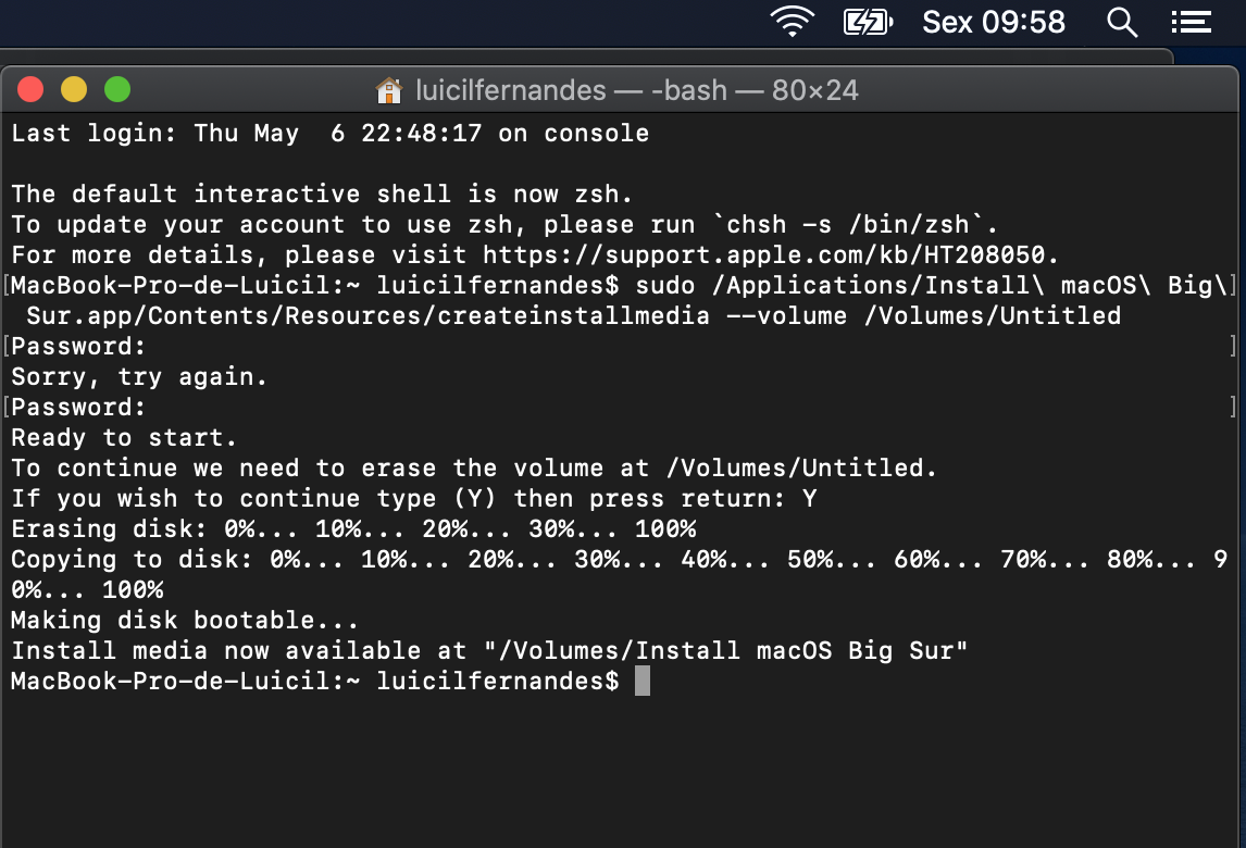

Hi guys. I am doing a new usb installer now.
I used this command in Terminal:
sudo /Applications/Install\ macOS\ Big\ Sur.app/Contents/Resources/createinstallmedia --volume /Volumes/MyVolume
At the end I will post the results.
Thanks.
Bootable disk ok.

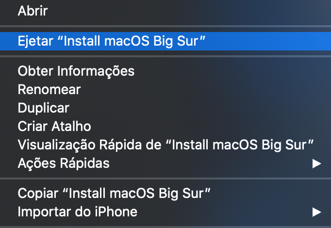

Ejecting the usb disk:
Found these two shared support disks, ejected them. Then was able to eject usb drive.
