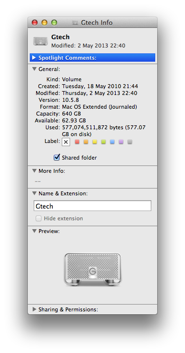

You can remote access your Mac with VNC software, if you also share the drives with other computers nothing else is needed.
Example, I have Apple Remote Desktop, I control my Mini with my Laptop, I also have externals connected to the Mini, you need to switch on file sharing and share the Folder/Drive.
(There are free VNC Apps available, ARD is NOT free)
In the screenshot below you see a "Get Info Panel" on my External drive, see the shared box is checked.

You also have to enable file sharing in the sharing preferences pane, there is also an option to share over AFP and SMB.
