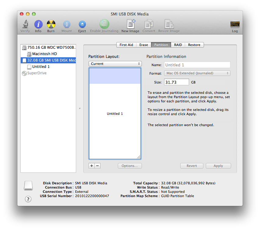

Thanks for your reply! Here is a screenshot of the Disk Utility how it shows up on my MacBook (where it also mounts in Finder).
While it doesn't mount on my iMac I think it recognizes it in the System Report-window.
No, it doesn't show up in Disk Utility on the iMac either. Also tried it on a friends iMac but it didn't recognize it.
