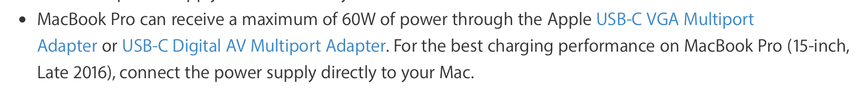

@Brookzy where does the 60W spec for the Apple adapter come from? Thanks!
@zhenya - near the bottom of this support article. 🙂 https://support.apple.com/en-gb/HT207256
