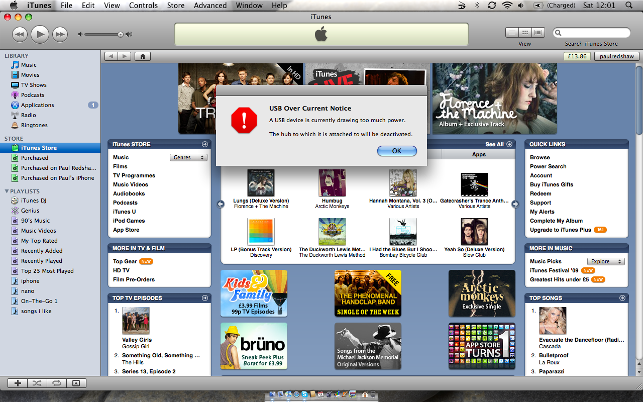

Plugged my iPhone in to sync today and got an error message saying it was 'drawing too much power'!!
The iPhone won't appear in the iTunes window so I can't sync it... Have tried resetting MacBook and iPhone but still get the same message (see attached pic).
Any ideas anyone or am I going to have to trek off to the genius bar!!

thanks for the advice,
it is the only usb device attached, i'm plugged into the wall and have tried both usb ports.... looks like i'm off to see a genius!

Do you have a powered USB hub lying around? If so, trying plugging your iPhone in that hub and connect the hub to your Mac... See what happens?
i went to the genius bar, turns out it was the data cable that was faulty and not the macbook or the iphone.
they swapped the cable and worked perfectly, they said it must have just been a dodgy connection in the cable somewhere.
