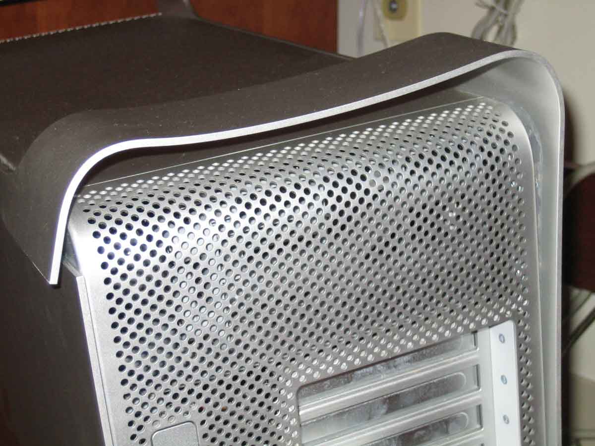

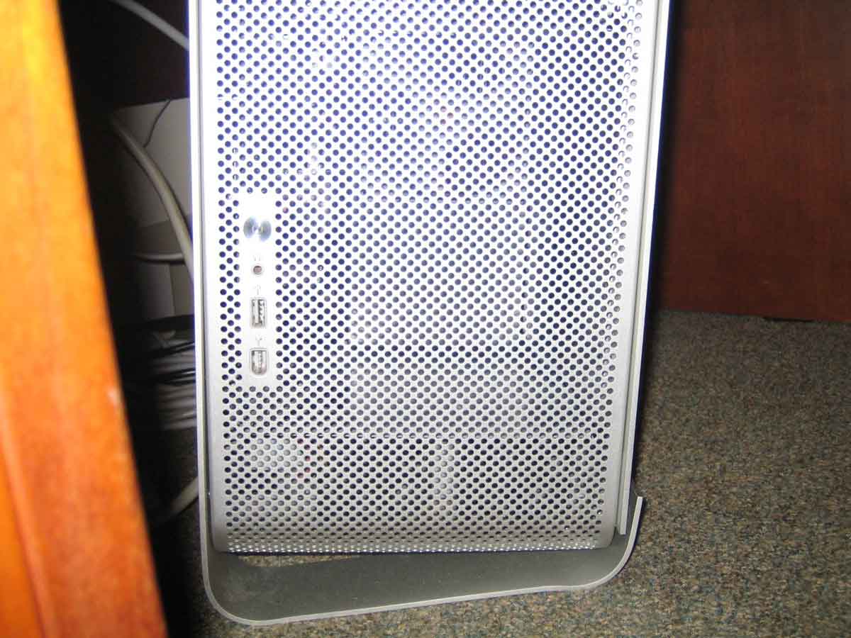

here are some pictures of the damage, just for your amusement. It seems like something really heavy was dropped on it.

Hmmm.. Someone a while back was considering selling a machine like this as "works fine just dented". Guess this goes to show that the internal works may indeed have their life shortened by extenal battering.
This is a long shot, but you might take a look inside and see if anything (aside from the dents) is obviously wrong. A partially severed wire, maybe; perhaps some sort of loose connection.
I've never spent time inside a Power Mac, though, so I could be totally off.

I've never seen a G5 take that kind of damage, that must have been a fricking heavy object.

One repair guy I talked to suggested that they lowered a forklift blade on it. That would do it.
