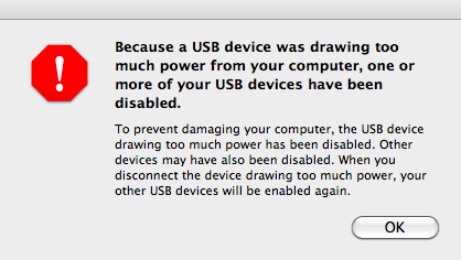

Well they don't look bent. I put a pen inside it to fiddle about with it and bizarrely, it came up with this error message (link)
Anyone know what it means?

What that means is that the pen is allowing a current to flow directly between the power pins of the USB port, causing Mac OS X to see it as drawing too much power (just because a surge has occurred and been detected).
