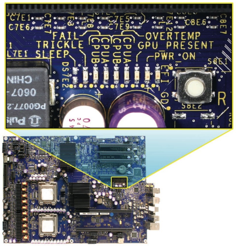

After it didn't work the first time, I shut it all down again and tried to find the manual reset button inside my computer. I read some things about it being under drive 4 but I could not for the life of me find any diagnostic lights or anything I might be able to see under drive 4. I bought my Mac Pro in 2007 so I don't think the thing about it not existing would apply. I couldn't find any pictures that would help me locate it, so I just put the case back on and followed the instructions for resetting again, still no dice.
Wow- that is disappointing news. 🙁
You got me wondering where in the heck I had seen a pic detailing the location of the SMC switch in your model (since I couldn't just look in my early 08 MP because it doesn't have that switch any longer) and finally came up with the following shot that shows it (the white button) in relation to your logic board. Now finding it behind the drives and everything else is up to you! 😉 I too saw the note that it was behind the 4th drive slot, but from looking at this pic I don't know- it does look possible though. 😕 At least this will give you a target to search for- and since it meant to be reset I can't imagine it being too hard to get to. At least I hope for your sake, as what you want to do next is what I would do too.
