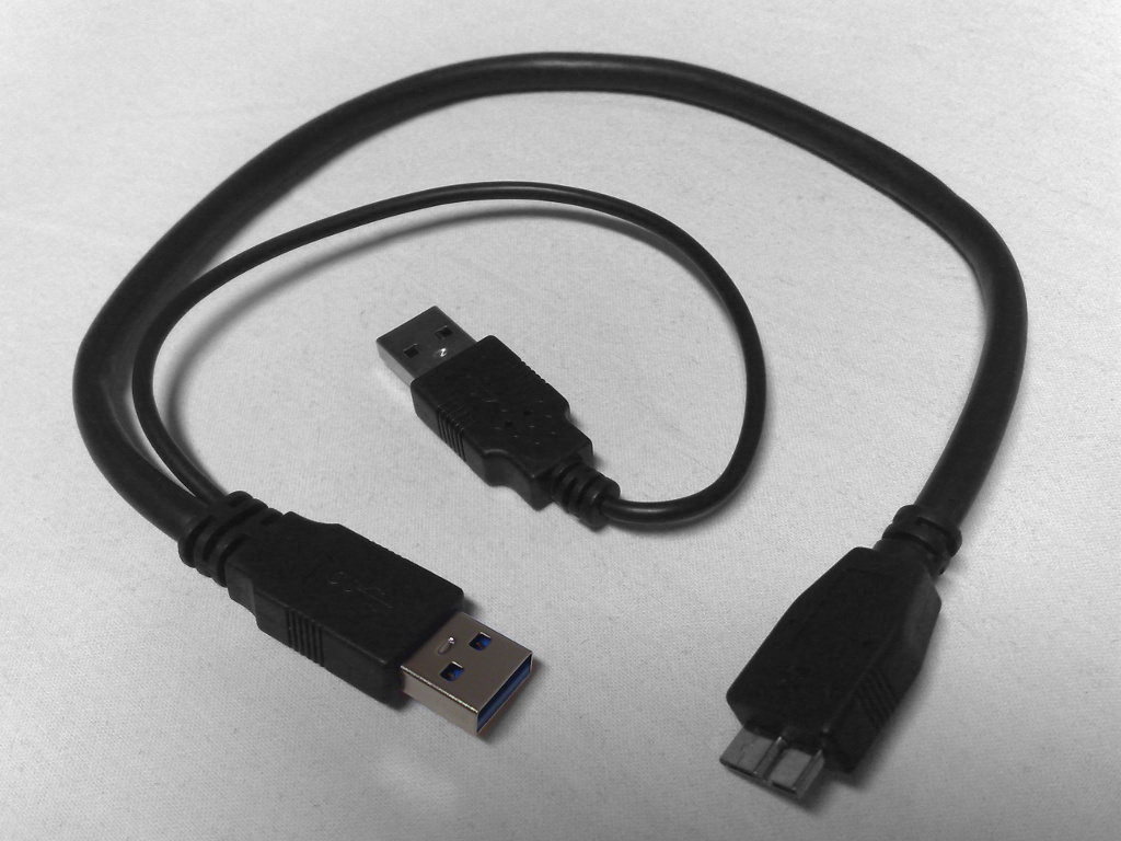

The 15" Alum PowerBook USB port's lack enough power to drive a USB hard drive or a USB solid state drive. To be clear, the USB ports work fine and can power a standard USB thumb style drive. So I started searching and the best options I found appear to be this cable or building your own.

happyfrappy Thanks for the information, much appreciated. There are a few of those 'Y-adapter' cables in my junk box. Haven't pulled them out because they all terminate in a Mini-B plug and the drives I want to connect all require a Micro-B SuperSpeed plug. At some point I plan to build a USB hub that's powered from the A/C adapter (think pass-thu and also a way to keep the number of AC outlets at 1) - but until then I'm using a powered USB hub.
A search turned up the below cable that has the Y you mention and the SS plug I need. Not certain if using both of the 15" PowerBook's USB port's would supply enough power (or not). It's available on Amazon for a very reasonable price, $3.99 (USD). When I submit my next 'Free-Shipping' order I'll toss one in the cart.
