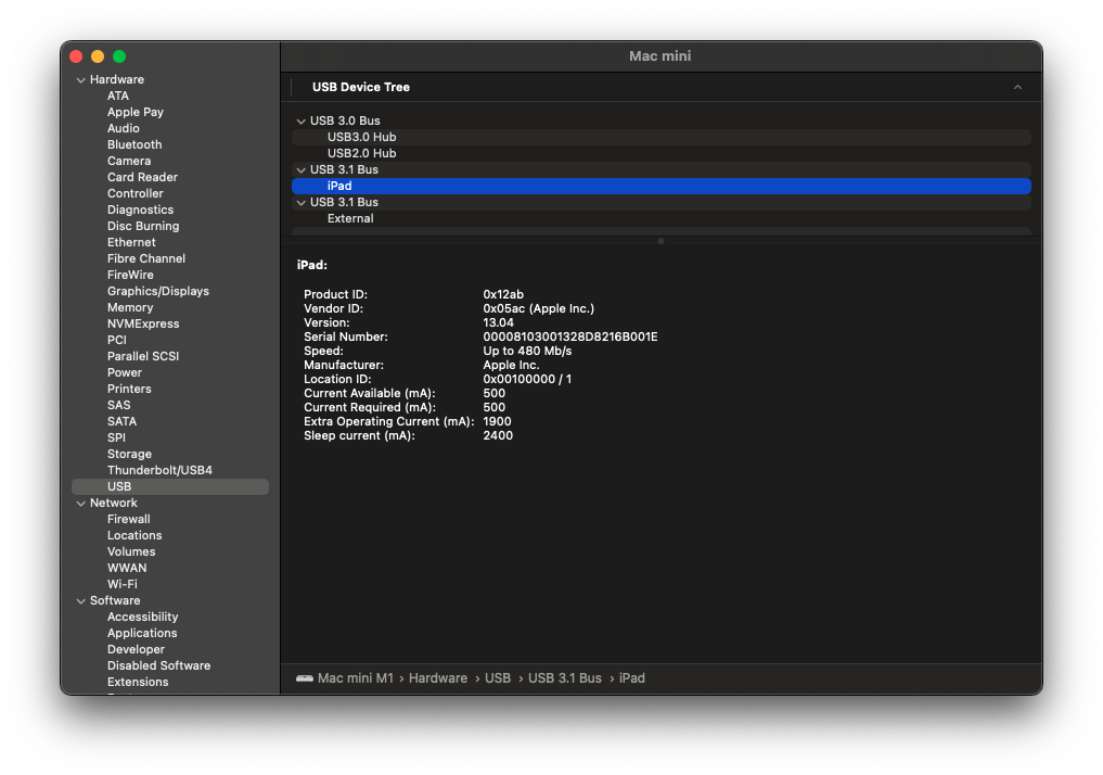

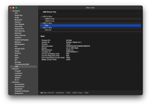

On my M1 Mini it's my understanding that the USB Type A ports can deliver 500mA and the USB Type C ports can deliver 900mA of current. The ports don't support USB PD. I believe the MBP is the same (minus the Type A ports).
The system report lists these values as the "Current Available" line.
@jwahaus - The Type-A ports can also deliver 900 mA to a device - otherwise they wouldn't work with most 2.5" portable HDDs that typically take that much power. If you plug such a "SuperSpeed" device into the Type-A port, you'll see in System Information that it does say "Current available (mA): 900".
By the way, this is the current available to a device, not necessarily the total amount of current available from the port to a hub supplying multiple devices, or to a device to charge its battery in Battery Charge mode, which is different from PD. I was hoping to find exactly what the Mac mini supports in terms of these, but I haven't yet...
