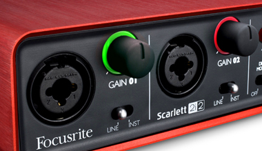

So these 2 inputs have my phono and another input combined? Kind of a 2 in 1 thing?

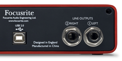

What are the 2 outputs on the back for?
So I would use this unit to plug all instruments and microphones into and output via the USB cable into GarageBand?

It is powered by USB. This box is what they call a 2x2 because it has 2 audio inputs and two audio inputs. You might plug-in a microphone and a guitar to the inputs and the outputs would go to the left and right monitor speaker.

This audio interface would work absolutely fine for your uses. You can plug any instrument or microphone into either input - it doesn't matter. You can also have a stereo keyboard for example plugged into both the left and right inputs for stereo recording.
