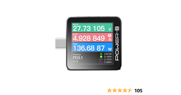

I have this gizmo on my Xmas list… it reads an e-identifier from the cable to let you know its specs
Reactions: EugW
Heh. I watch the ChargerLAB teardown videos myself. I was tempted to get one of those, but I couldn't get myself to spend CA$110 to test my cables.
