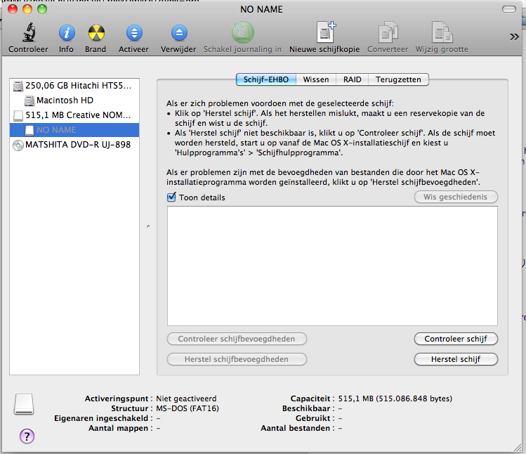

It shows up, and I guess it's not mounted?
Here's a screenshot of the disk utilities:

Thank you for your quick reply!
I selected NO NAME, but I'm wondering which function is the Mount function?

Sorry, didn't read the button texts in your screenshot.
It is the button with "Activeer" written under it.
Okay, that didn't work "Disk NO NAME" can not be activated.
It says: Try again with Disk EHBO

That's not a good sign; it sounds like the partition got corrupted. This could have been because the PC did something bad to it, in which case you might be able to recover the data by repairing it, and at least can keep using the stick by reformatting it. Or, it could have been a hardware failure (either by sheer coincidence, or because there's something wrong with the USB port on the PC), in which case it's toast.
Try this: Click the greyed out volume, then click the "Repair" button in the "First Aid" tab (that would be "Herstel schijf" in the "Schijf-EHBO" tab. If you're lucky, it will get repaired, or at least you'll get a message that it couldn't be fixed and it will get temporarily mounted so you can copy files off of it before reformatting. If you're unlucky, the repair will just fail.
If that doesn't work, you could try doing the same thing with a Windows disk utility, and see if it is able to repair the partition. Or, if the data on it isn't that valuable, just reformat it and try again, although I'd be careful in case it's a hardware problem--it might happen again.
