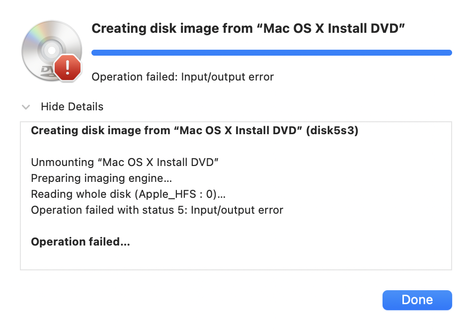

Doesn’t work with the official adapters on a 14 inch MacBook Pro
