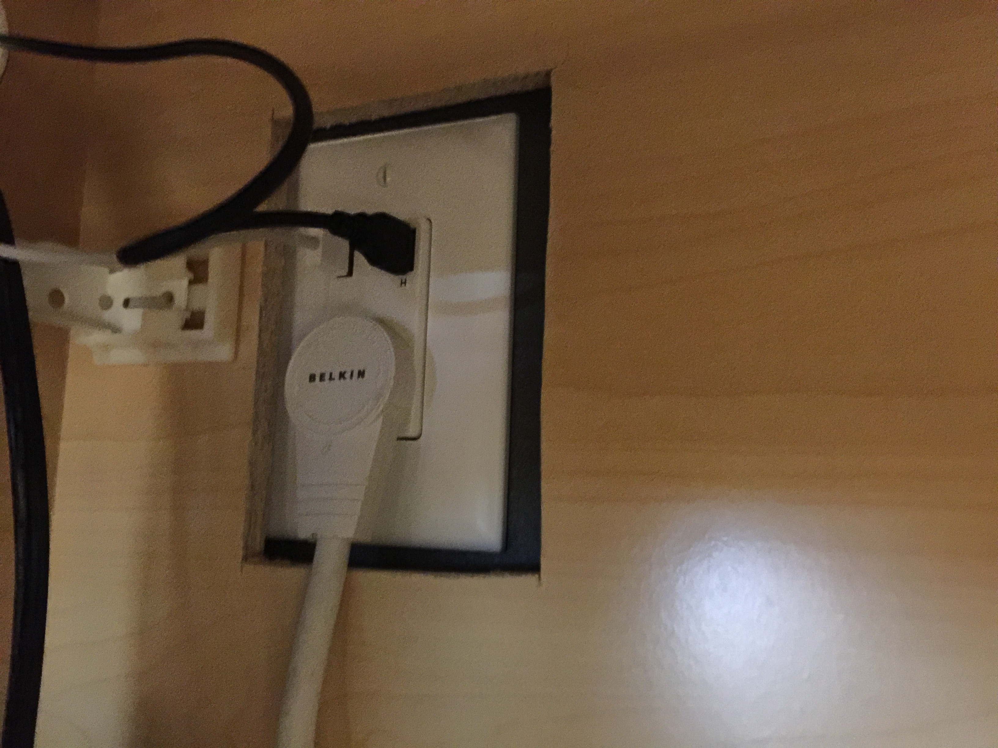

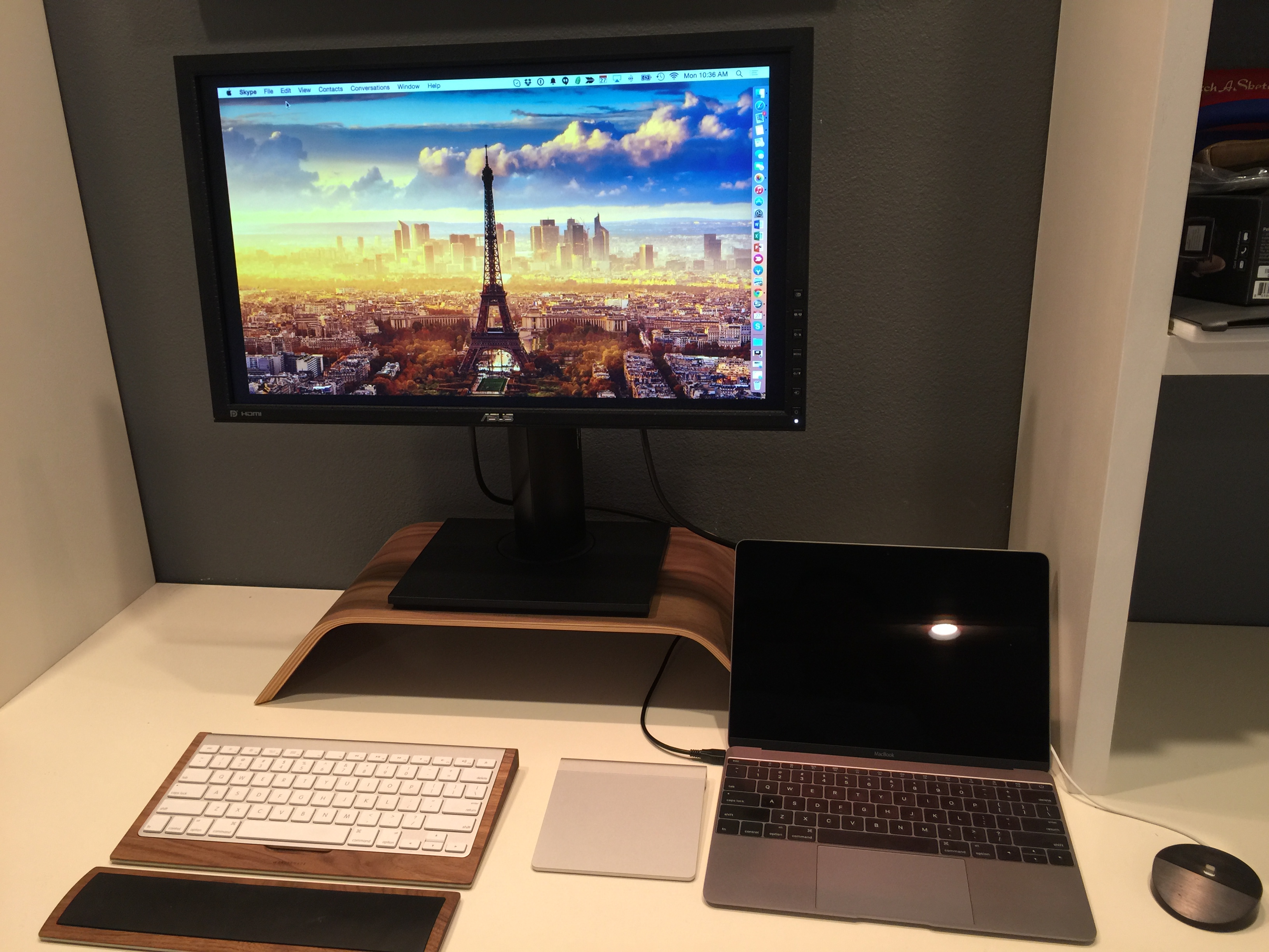

I'm charging using a newer tech wall charger to charge my macbook along with a USB C to USB cable I got from Amazon. I'm not sure I'm killing my MB or not, but so far it's working perfectly. My battery has not run down at all. I don't know if it's truly charging or just maintaining.
Beautiful setup you have going there! I'm thinking of installing a few of these charging plates as well.
I'm curious about whether it is going to hurt my battery or not too. I hope if it does, it does it within the first year - so applecare can cover it. "Of course i was only using the charger that came from apple.... 😉"

Thanks very much! It's working quite well using the Apple TV and airplay mirroring to do my daily work stuffs. But the picture is not great. I have a USB C AV adapter on order and will use HDMI when that comes in (in 4-6 weeks 😡)
But other than that, my only wish was that the Apple BT keyboard had the same feel as the retina keyboard. Also, wish the trackpad was force touch. I've become so damned spoiled in a week 🙂
