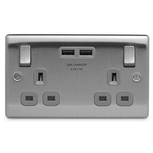

I'm thinking of installing wall sockets with USB points in them. Will these continuously draw power even if nothing is plugged into them, much like regular power adapters? And if so, are there any on the market which don't - as in they have an on/off switch?

A few second searching for 'wall sockets with usb continuously draw power' turned up tons of articles on the subject. They do, though there are some designs that draw less, and some like this:
https://www.newertech.com/products/power2u.php/
That actually have a cutoff for the USB ports.
This is a pretty interesting question, and I did a little research. I guess a lot of people were wondering the same thing, as there are plenty websites on this topic.
I thought that there would be some draw of energy from USB chargers when not in use, but it looks like there is a very, very small amount of energy that is being wasted from most USB chargers.
In the US, it would be about $0.05 a year worth of power used from one USB charger. Electric is about twice as expensive in the UK, so about 10 cents a year for you per USB charger.
I am not sure of your intentions of wanting the USB charger to totally turn off when not in use, but if it was to save money or energy, it probably wouldn't be worth it to most.
You can get a switch/USB combo and have the switch control the USB outlet. You can wire it for the outlet to be always on or be controlled by the switch.

Good find. Unfortunately, UK sockets don't come in that shape. I did manage to find UK wall sockets with USB on/off switches on Aliexpress, like this one:
