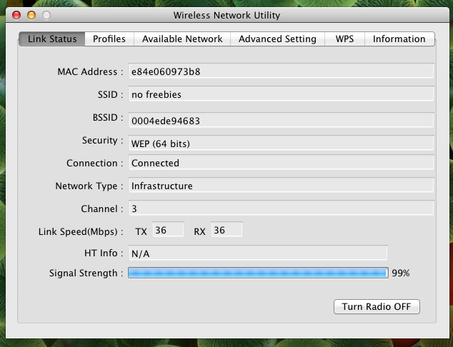

So I bought a USB2 Wifi adapter and it only gets 36mb/s 😡
It's effectively useless at these speeds, it means I can't use it with my Apple TV at all... What's going on? It's supposed to be 802.11n...
Clearly its not, I thought USB2 was supposed to be 480mbit a second I should be able to do 802.11n with USB2. Is there anyway to force 802.11n on a Mac?

According to your second screenshot you are using WEP. Aside from WEP being more or less the same thing as no protection at all, the maximum transfer rate for 802.11n using WEP authentication is 54 Mbps as specified in the IEEE 802.11n standard. (Related reading)

No. USB WiFi and USB mass storage are not quite the same. The link speed most definitively is not 36 MB/s. Believe it or not, the label says "Mbit" for a reason.
I didn't realise WEP would limit traffic like that... I realise its not secure, but I don't live in an area where I'm likely to get hacked and I was just testing this to make sure it worked. eBay purchases are very hit and miss.
Anyway, it's now running WPA2 and is running much faster, thank you 🙂
