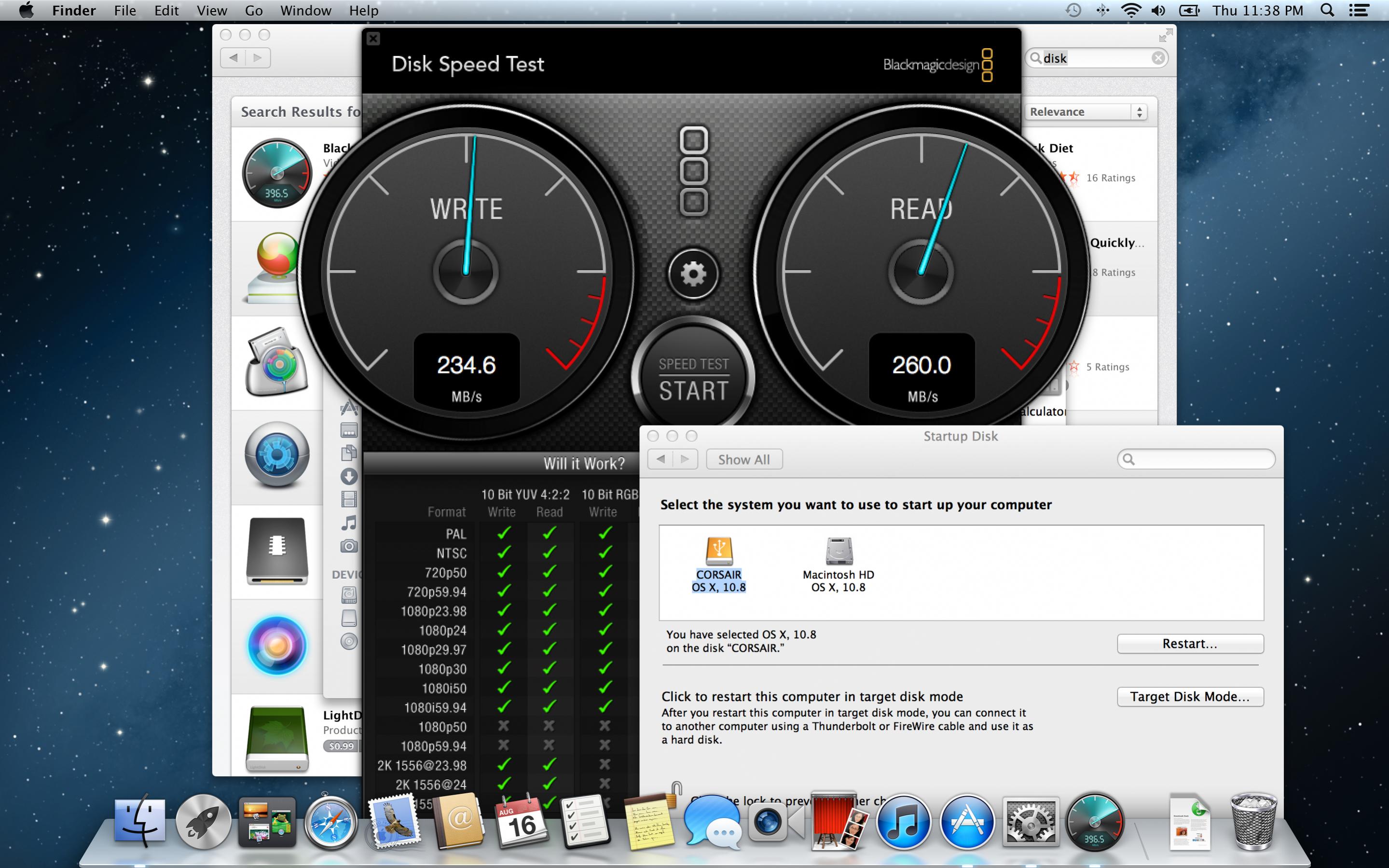

It works flawlessly. Installed Mtn Lion via USB to the Corsair SSD inside the USB3 enclosure. Also re-ran Disk Speed test, results didnt vary much but were slightly faster.
Screenshot attached.
