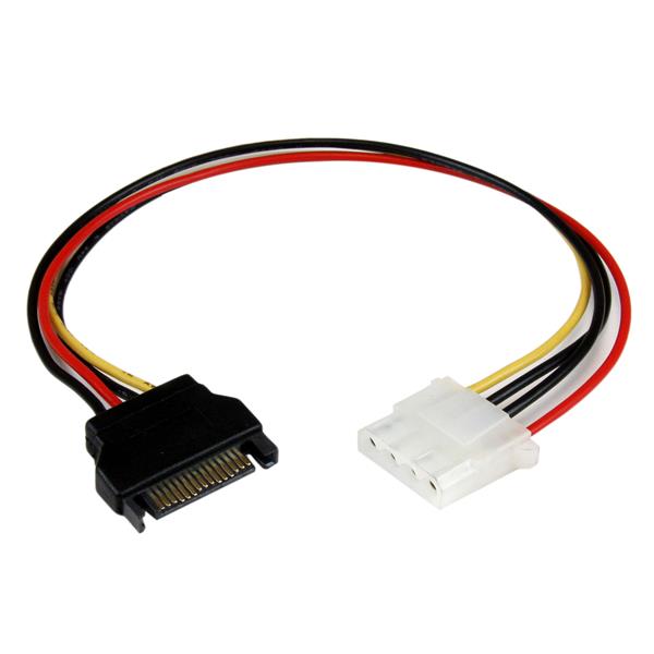

It shows up no software or additional kext needed. But I need an external power source to connect to this USB 3.1

Again i have to use this cable

It's a bit inconvenient with extra power cable, but i guess it delivers 1.5A @ 5V, therefore additional power is needed
I'm a little bit pissed about this (not at you...at the card makers).
We went through this with the USB 3.0 cards, where supplemental power needed to be hooked up. It's a pain in the MP to do this--I've done it.
And it's not necessary! Today there are plenty of USB 3.0 cards that draw all their power from the PCIe slot.
The PCIe slot provides up to 75 watts of power. 1.5A@5V on two ports is about 15 watts. So there is WAY more than enough power from the slot for this USB 3.1 card's output.
I don't want people to have to go back to routing power cables. I'll assume it's the same lazy design issues we put up with last time for the early USB 3.0 cards, and I'll hope that future cards will eliminate the separate power requirement.
