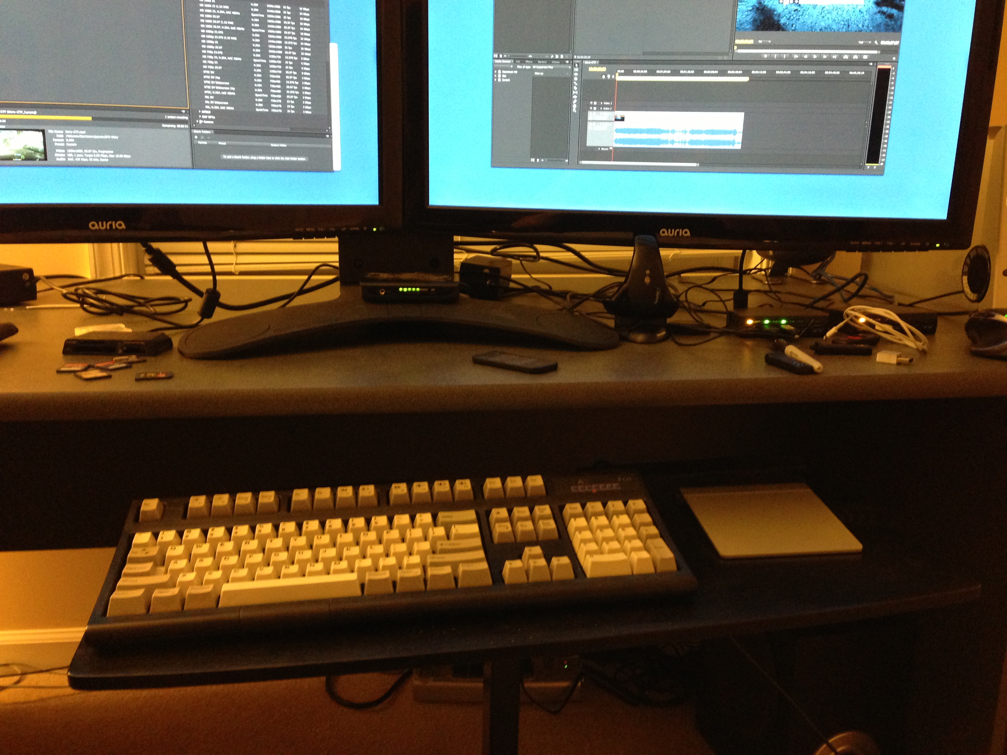

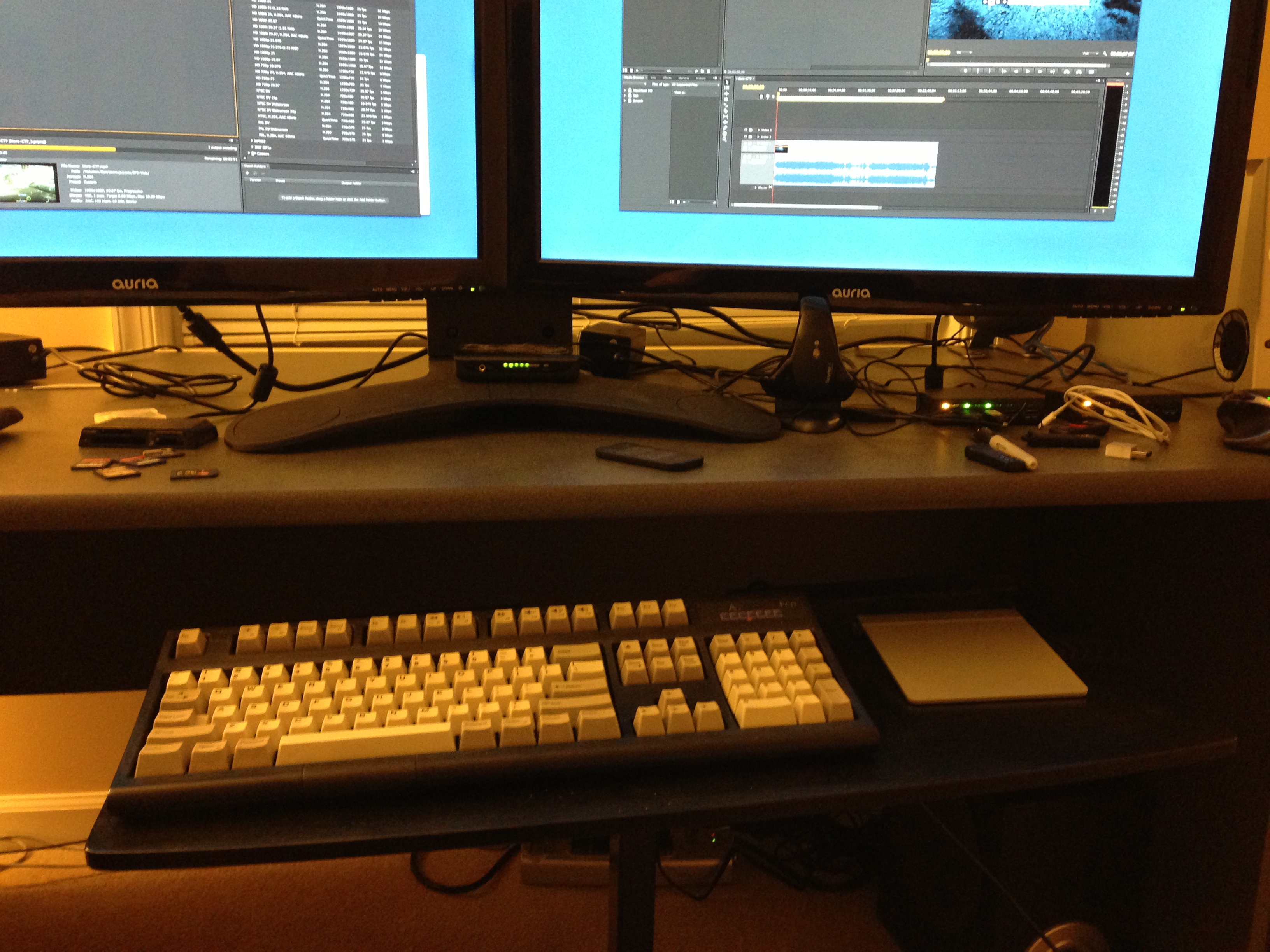

Note the two hubs in the lower right part of the picture. They're both USB 3 hubs and they work just fine. But I'm not using the CalDigit card.
