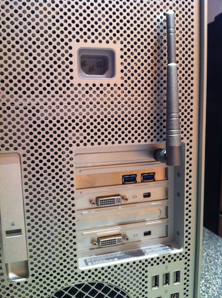

The only solution appears to be to use an external Bluetooth antenna & I have just had an Mini PCI U.FL to RP-SMA Antenna WiFi Pigtail Cable & Antenna to RP-SMA Extension Cable delivered so as soon as I have fitted that I shall hopefully be able to report back that this does indeed fix the problem.
It doesn't happen with the HighPoint card that I've seen. But yeah the fix is just a ten or twenty dollar amazon purchase.

I can fully endorse the external antenna method, my Magic Mouse was poor without USB 3 and appalling with it (I tried Highpoint card, generic NEC card+kext, and an Orico card).
Now BT is 100%.

Another solution using your built-in BT module is an external antenna...
https://forums.macrumors.com/threads/1116546/
attachment.php
I haven't had any problems running USB 3.0 with this solution.
